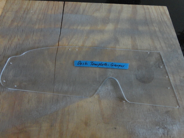

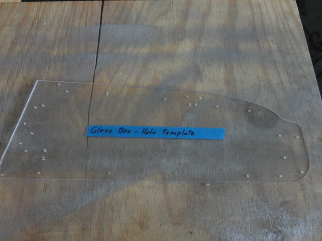

Does your new dash have ALL the holes drilled behind it for the screws?
No the dash wasn't predrilled for the screws(that would have been nice!). I thought I would try and match it up with the old one and drill the screw holes. Any suggestions?
I made these two templates from clear plexiglas using a router with a template bit. I then drilled the holes directly through the plexiglas using a small cheap bench drillpress(Harbor Freight). Caution should be used in making sure you use the same screws in the same holes and do not go too deep in the wood. Use a scribe to measure the hole depth and then get a correct size drill bit and install a collar on the bit so it won't allow the bit to go too deep.
I have spare dashboards and the templates line up with them so it's probably something like this that the factory used. The new glove boxes you can buy today do not line up with the same holes so keep that in mind but the other screws on the glove box side do line up such as the center panel and end curved piece.
