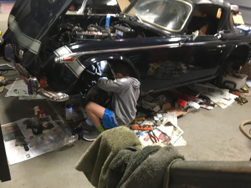

I've been working on a TR250 that hasn't run since 1979. Engine now purring beautifully after a carb rebuild, new points, cap wires and plugs. Hoses all new, and a complete brake job - new master, booster, shoes, rotors, hoses, rear cylinders and calipers. I replaced the clutch master, slave and hose but the trans will only do the 1/2 shift and not cleanly. Can not get the car into 3 or 4. Can get reverse but again not as it should. I'm mostly a Healey/Corvette guy and I'm wondering if there is oddball something or other I might be missing. I bought the car a project to do with my grandkids and I would like to sell the car as one that is a solid driver needing no mechanical work.
