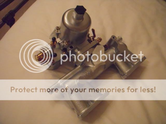

My newest addition arrived today. Got a Hitachi 1 3/4 Carb matched to a 1500 MG intake to replace the current HS4 1 1/2 setup. Gonna dissemble and clean up some porting on the carb yet but should have it on and dialed in next week some time. Gotta say that Hitachi carb is gonna look great in there.
Anyone interested in my HS4 and Manifold let me know. Its a stock Carb completely Micro Polished, with new throttle shaft and valve. Looks and works like new, and the manifold was glass beaded too. PM me if your interested in the whole setup. Less than 25 hours on it. A true bolt on and tune.

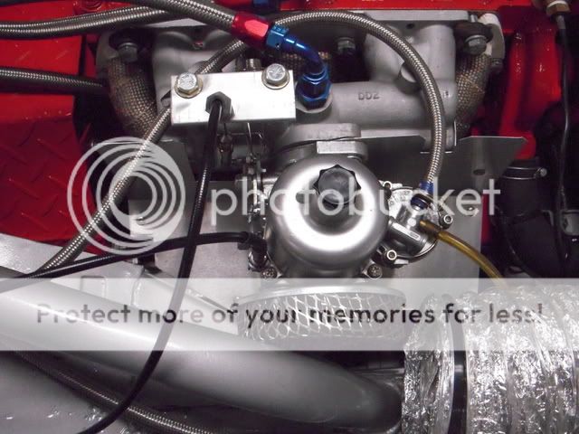

yep, played with that page several times for info. Yes the manifold had to be re-drilled and tapped to accept only two of the four hitachi studs. But should hold up. I like the bracketry of the Hitachi, but the main reason for picking it is in its stock foprm it suppossedly flows 20% better than the HS6 SU plus the Overall length of the Body is 1/4" shorter than the HS6 and as you can tell from my pics every bit of space is needed!

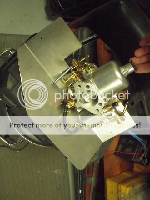

Started prepping this carb a bit ahead of my own schedual. Ported the carb a bit, clean up the manifold. (Wasnt as perfect as I thought but definatally workable. But most of all got to quickly fab a nice heat sheild and return spring setup out of a piece of stainless one of my guys at work had.
