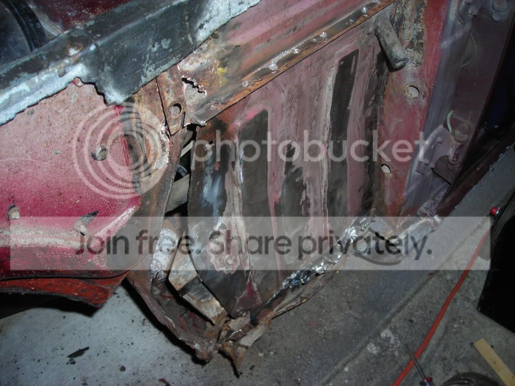

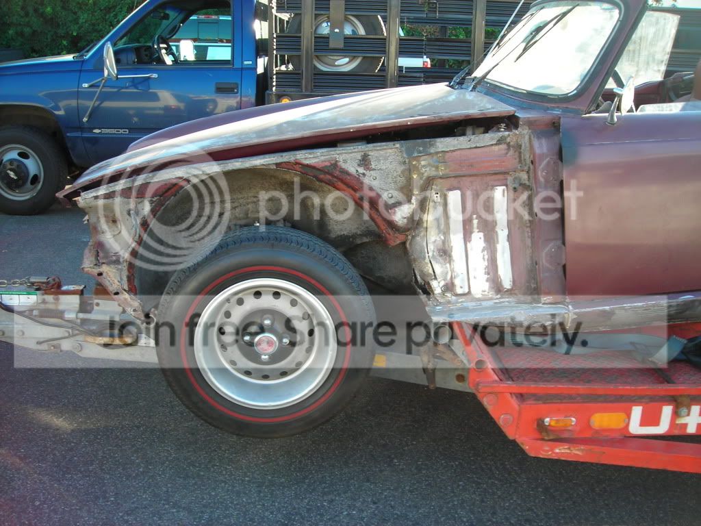

Here is what it looked like when I pulled the fender off. Much worse in fact than it looks in the picture;
Then this happened, which didn't exactly help the panel alignment much;
Once I cut the outer sill out the bottom of the bulkhead was toast, as was the inner sill and part of the floor.
I'm skipping some steps here like fixing the floor and the inner sill, but I've posted those repairs before already.

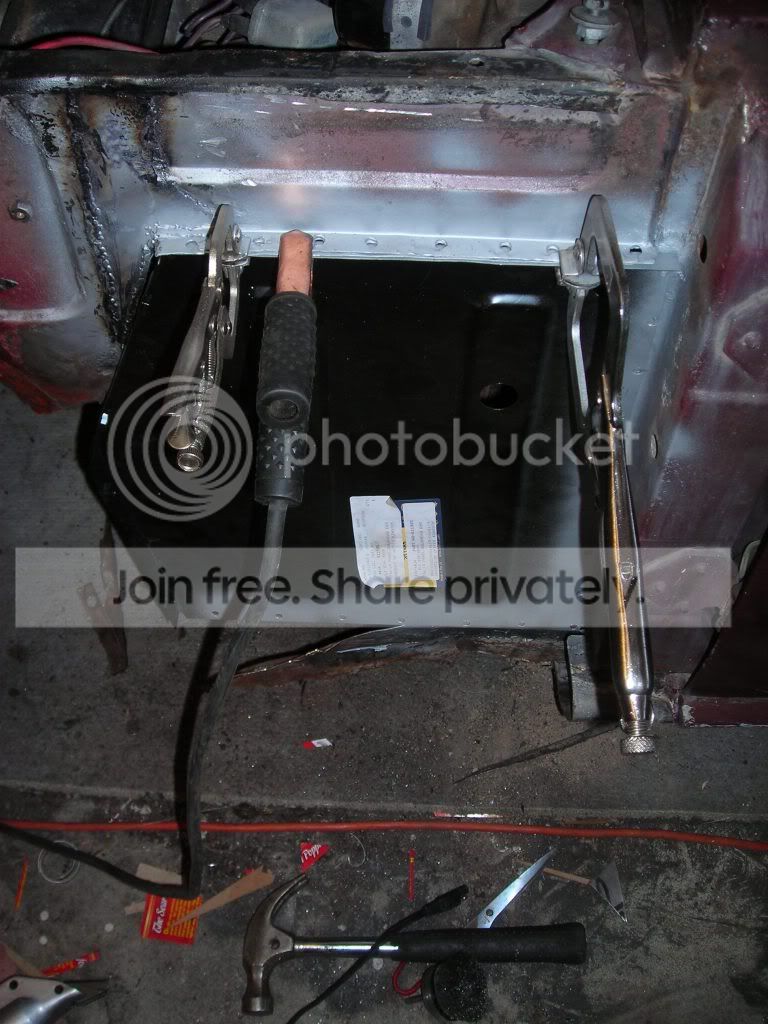

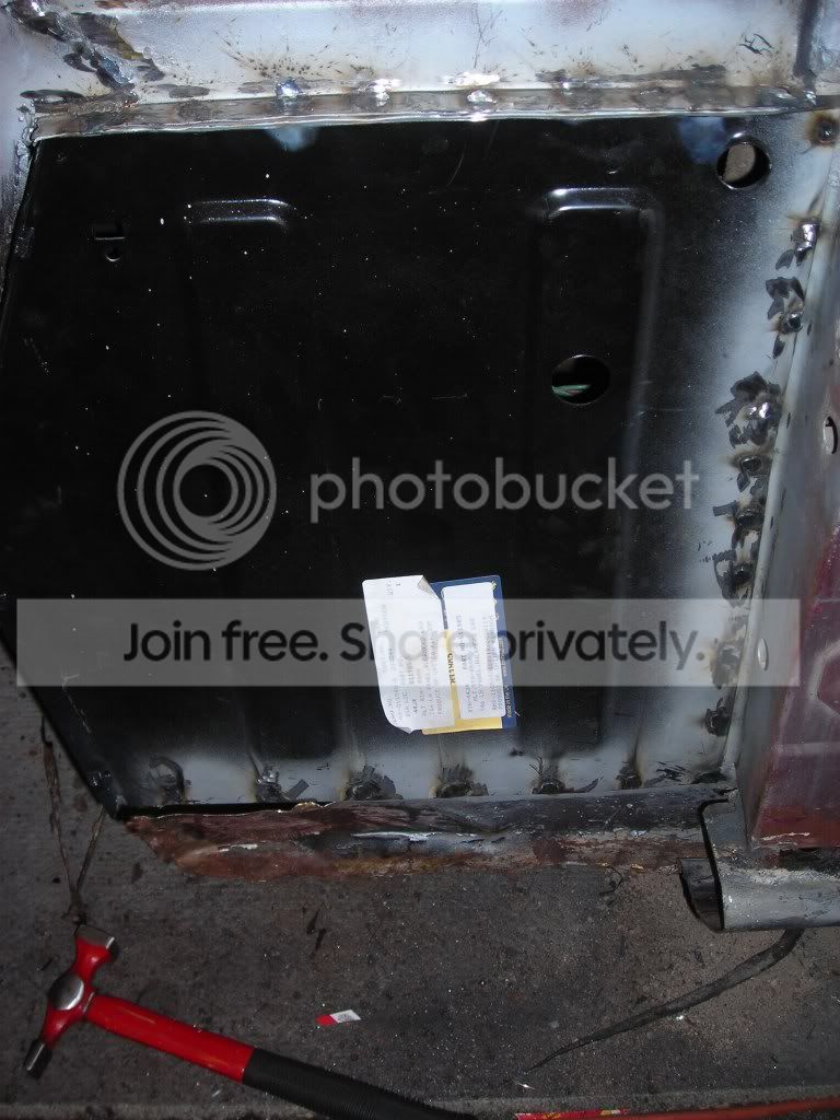

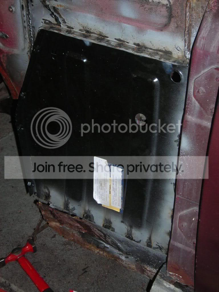

So after much prep and another repair to the area immediately on the left here comes the panel;
I still have some touch up work to do, but once painted I don't think it will look too far off the original welds. (Don't mind the mangled sill part down below)
Kerry & MD - your welding tips. Welding a spot and then grinding it down before hitting it again made a <span style="font-weight: bold">big</span> difference. Thanks!
