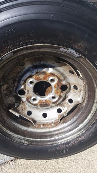

I dropped the wheels off a Rim Renew in Catonsville, MD. Neither the owner Sam Friedman or I recognized each other, even though I played his wedding back in 2011. My little dinky 13s looked a bit out of place among the modern rims of 17, 18, 19 and more. But, it turned out Sam is an LBC guy, too, with a very original and very clean TR6. Sam looked at my tires and said "Man, you really do drive this car". We put the wheels on his machine -- every single one of them was out of whack to varying degrees, with the problematic left front being the worst. It was so bad, he suggested using the spare instead of trying to fix this wheel.
His recommendation was that the two best wheels after straightening should go on the front while the two lesser wheels go on the rear. I don't have an issue with that. When it comes to tire rotation, though, can I cross rotate the fronts and rears, put the left tire on the right side and vice versa with no front to back rotation? The BMC Manual has the fronts going to the rear, then the rears going to the opposite of the fronts, i.e. right rear to left front, left rear to right front.
Sam will have the wheels for a couple of days. I'll let everyone know how it turns out. He thought that there would be a dramatic improvement based on how wobbly the wheels currently are.

Update: Wheels are almost ready. Sam had a problem with the wheels -- the lug holes on the Sprite's wheels were smaller than the lugs on his straightening machine, so he had to order an adapter to make them able to be worked on. I should have them back within the next few days.
Like 13 inch wheels , 3/8 inch stud holes are not very common these days.
Got the wheels back -- slapped them on the car and WOW. What a difference! Even more remarkable is that I nailed the toe-in almost perfectly just using dead reckoning. I'd say my adjustment was around 95%, and I'm not sure trying to chase that last 5% is worth it...I'm just as likely to go backwards as I am forwards.
Even though there was a light drizzle in the area, I couldn't resist taking the car out. It feels like a slot car now. I didn't realize how much the bent rims were disrupting the handling of the car. I took the car up to 65 miles per hour and it was still riding smoothly.
The wheel straightening came out to $240. The set of tires came to $252. So, for under $500, I dramatically improved the Sprite's handing. That's a pretty good investment.

With all this talk about BE wheels, there were actually three different designs. The first one was where the rim was riveted to the center. The second one used had the rim welded to the center and the brake adjuster holes were in line with a ventilation hole (see post #9). Evidently when racing, cracks developed between the brake adjustment hole and a ventilation hole. The third design "clocked" the position of the brake adjustment holes and the ventilation holes so they were no longer lined up. This third design was considered the strongest.
