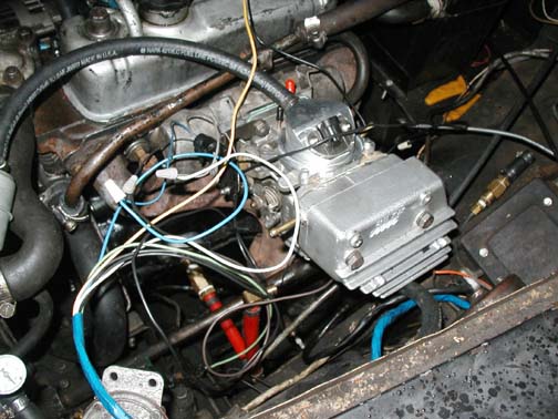

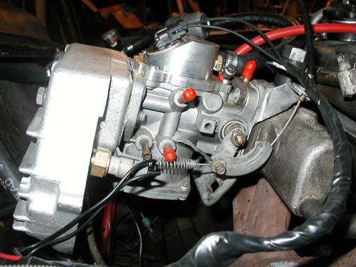

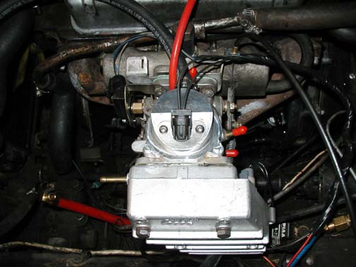

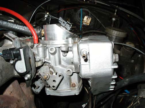

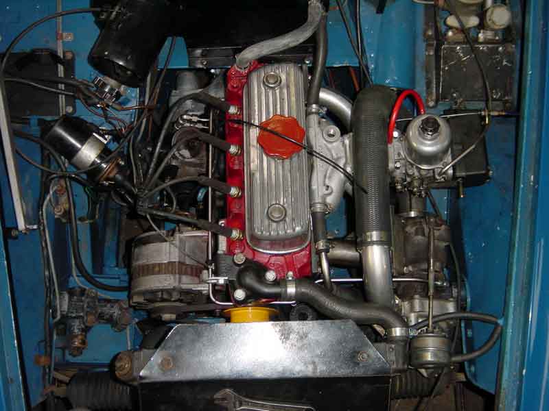

I got the car started tonight on the fuel injection!! WOOO HOOO.
Of course the HIF44 carb body is the throttle body, hence the extra 5%.
It only barely runs since I still have to find a better place to hook up the MAP sensor - I think I have it hooked to a ported vacuum source right now - also the fuel maps aren't anywhere even close and I'm just running on the narrowband at the moment. Also, disregard the wire nuts in the picture.
those are just temporary.
Once I get a wideband and do some tuning,
Wow, I can't explain the relief and excitement when that EFI fired up right away! :banana: :banana: :banana:
It's a long road ahead but this was another important step on the journey!
