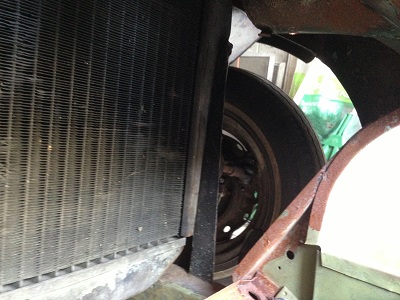

007 Resized.jpgBill, Fabulous I knew there was an answer. What I'm looking for is the back part of the valance that has the shrouds that fit up against the radiator. On the '58 early bonnet the bracing / shrouds on the side of the bonnet came down at a 45 degree angle on the sides and did not line up with the radiator. This may or may not work but I'm thinking the shrouds on the back of the valence on a Spridget bonnet could be repurposed for use in the Bugeye. It may or may not work and I'll look to Trevor as he fabricated shrouding to fit the bonnet on Ugly Bug for a forward tilt bonnet. Trevor since you have a BE and a Spridget to compare sitting in your garage, could the shrouding on the back of a Spridget be repurposed for use on Bugsy II to strengthen the bonnet and route air properly.
Bill here is a pic of the side of Bugsy II's Bonnet and I'll need to send over another picture that shows how Trevor fixed. Again the thought is to do with Spridget sheet metal rather than starting from scratch. Thought is to use bracing and shrouds and line up with radiator supports like a later BE Bonnet. May not even be possible but I believe shrouds on the back of a Spridget Bonnet can be repurposed. Heres a pic of the back of a Spridget valence. Opps doesn't want to load one more send coming.
After taking a look again at what Trevor did I now am having second thoughts on repurposing. Take a look here at how he extended the 45 degree panel https://www.britishcarforum.com/bcf...-Crossmembers-for-an-early-58-BE-Bonnet/page2. That looks to be easier than cutting a valence apart as the. A brace on the top between the headlights and tack weld a new panel in place. Bill thanks for the offer. Once I get into that phase I may take you up on the offer.
