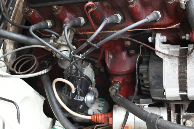

I really hadn't looked, but had assumed that it was something more modern. In fact, it IS a Lucas with the internal regulator. The "kluge" is that it uses the original alternator mounting bracket with a long bolt and a thin sleeve forming the rear brace.
I believe we got this "extended" bracket through Moss, but don't remember for certain.
