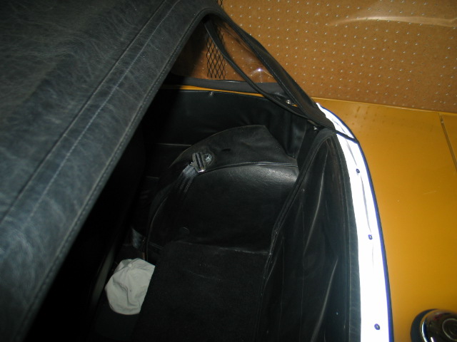

I didn't use inertia reel type, but the mounting point on the '72 is already in the car. The photo (if I can figure this out) shows the top mount. Most likely you already have the bottom points.
