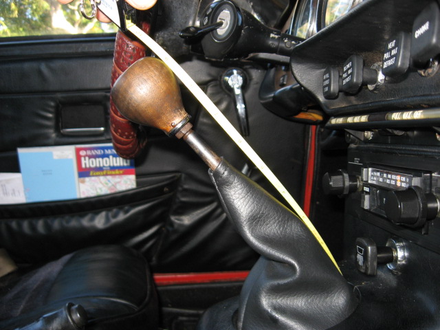

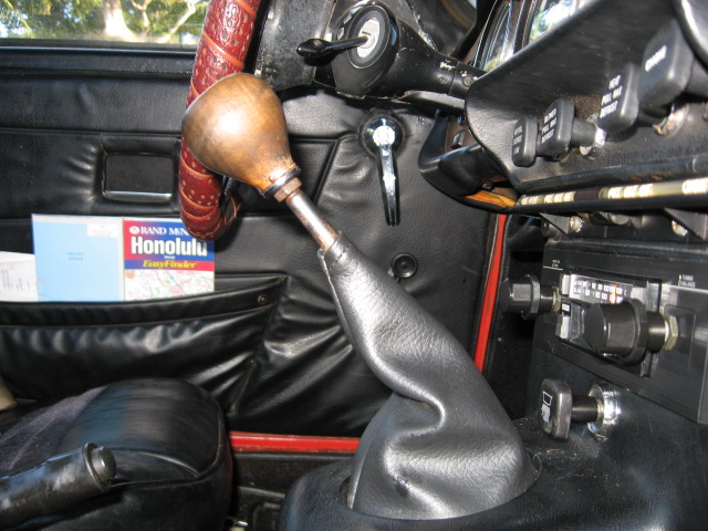

Conversion Components sent the wrong shift lever for my Toyota 5sp conversion (it fits but the bend and length are wrong), They need a measurement from a TR6 shifter (seems like they would already have it being they make the conversion ??). Could someone please send me a measurement in the neutral position from the top of the dash support--boot opening and following the curve of the lever to the top of the lever .Also if anyone could post a good picture showing a side view of the shifter in the neutral position. I would appreciate it and I Thank You in advance.

Howzit Allan. I just put a renewed transmission in and the passenger seat is still out so I can take some pix from a dead-level side view. The measurement from the top of the shift boot opening along the curve to the top of the wood shift knob is 9.25 inches. To the top of the shifter itself would be about 8 inches. (First pix)
The US Air Force expects me to be at work in a few minutes, so gotta go. Hopefully you can use the pictures to clarify exactly what measurement you need and someone else can assist. Good Luck!
