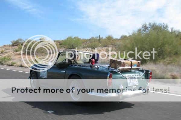

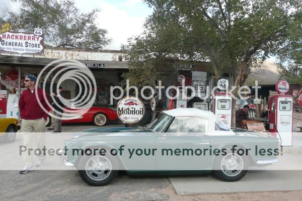

My approach has been to have multiple sets of tires using both the stock rims and wider alloys, swapping them on and off as the mood (and driving plans) evolve. I enjoy the special handling characteristics of the original skinny tires (165/15) but sometimes prefer the road manners of the wider ones (195/65/15). Like having two different cars (sort of).
I think it would be hard to use the same tires on stock rims now and wide alloys later -- though I have seen tires as wide as 205s on the stock rims. Looked a bit like this:

Yeah, I always thought it would be cool to have a set of wires with original size tires and a set of minilite knock-offs with some performance rubber...
When I was a kid I had a Schuco car that you could remove the wheels and swap on a set with a different color, also a Cities Services wrecker with changeable wheels. That's what got me started...
That plus top up or down, luggage rack on or off, etc -- a different car for every occasion.

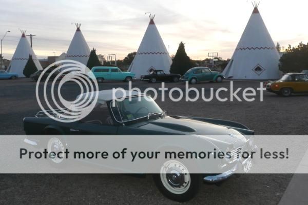

Geo,what are the mags in your last pic.Very cool.

ps. and I agree about Geo's wheels there. I recall when he bought them a few years ago, the seller actually had a little trouble selling them at first. Geo had the foresight to see how cool they looked.
They're 'Magnas' from J. A. Pearce, a Southall firm that made & marketed sports car accessories (esp wheels and steering wheels) in the 60s.
After many decades of dormancy, the firm is back and again making the Magna Wheels:
https://japearceengineering.com/products/magna-wheels/
https://japearceengineering.com/general/reinventing-the-wheel/
Thanks.Checked the links ,no pricing as each wheel is quoted after order,so probably out of my price range.
