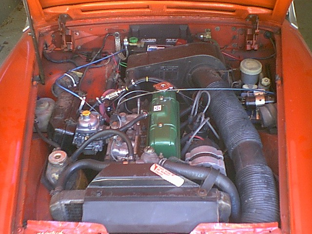

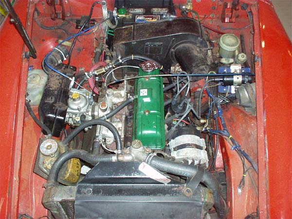

I added the 76 model radiator to my 1975 midget and I need to relocate the expansion tank and overflow bottle. I am not sure where these should be relocated to however and was hoping someone might have a photo showing this on their later model 1500 midget.
If you do I would appreciate it very much. Thanks ahead of time.
Here is one:
and another
I have a couple more, but I will need to resize them
Thanks, that helps me a great deal. It appears that the expansion (overflow) bottle is where my windshield bottle i. I kind of recall seeing somewhere that they subsituted it after 75 for this. Can you tell me where the windshiled fluid bottle is as I don't spot it. Also it looks like there must be screw holes for the brass tank backboard to screw into. Mine doesn't have any so I might have to drill and tap some I suppose. Anyways thanks for sharing this photo's with me. Nice engine bay, wish mine was as clean!
