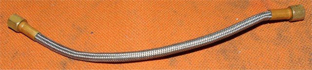

A potential buyer is coming to look at my MGB next weekend so I'd like to be able to show him good oil pressure.
I need to replace the oil pressure line that attaches to the oil pressure sensor from the side of the block.
Let me know if you can spare one, how much, and if you can send it to me by next weekend.

Brand new from Moss, they're not that expensive.
That hose is one thing I'd suggest having two of... One for the install and one for the boot as an on-board spare. I've had the newer (replacement) ones fail for nothing more than chance.
Cheap insurance in my estimation.
Take the failed one to any local (good) hydraulics shop. They may even be able to use your end fittings and make a new one. Think truck and earthmoving equipment here.

No,can't reuse the original end fittings once they've been 'crimped'....but they might be able to match the ends & make a new one.
Yes they can re-use the ends. They just have to install new crimps. I had this done for a friend at my favorite hydraulic shop recently when his hose gave up as he pulled onto my recently cleaned concrete driveway. It cost about $15.

What about British Parts Northwest? They're in your section of the country. I agree with Doc. Whenever I get a line that is NEEDED ASAP, I head for my hydraulic line people. Like Doc said, think heavy duty and Marine and aviation...
usually submit a sample and pick it up within an hour..
