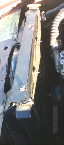

So what is it, is it an MG Midget 1500 radiator? A Datsun 210 radiator? Anyone know?

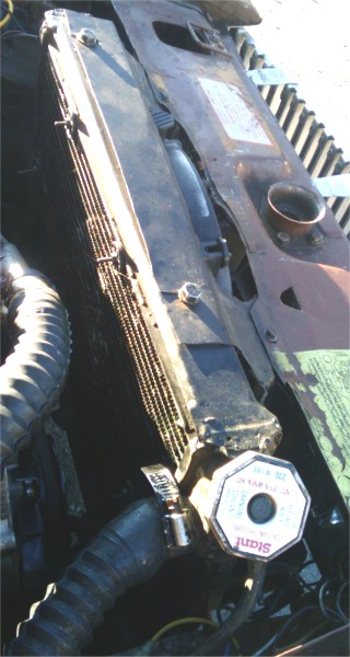

Other side:
definitely not a 1500 rad - they don't have rad caps except on the overflow tank
Right, but it's not like the Datsun radiator pics I'm viewing either.
Dimensions are: 20.5" wide x 12" tall x 2" thick
Well I figured out it's going to be very hard to figure that out so I pulled it and took it to a shop about a half mile from home where the guy repairs radiators. He used to build radiators and he says it might be a custom unit.
Top tank leaking at freeway speed, making a mess and likely to get worse if left alone.
Water escaping around the edge of the hood and spraying the windscreen - yech!

So I took it home and installed it and filled with coolant. Started the car and ran for a while. Seemed ok.
This morning when I parked I noticed fluid coming out on the side with the cap pooling on the ground. Hopefully it's just the cap and replacing it will fix that.
Wonder what pressure cap I need for the Datsun A15 motor? They should be able to look that up at O'Reillys.

I went to the auto parts place and their book showed a 13# cap for the Datsun 210 and B210 with the A15 motor.
So I bought one, I'll see where it leaks on the way home.
I do have an overflow tube and tank, need to make sure it's all good with no leaks too.
I use a 13# cap with my A15 Bugeye. Hopefully that's the problem and not a botched repair job.....I'd hate to see how long it'll take them to re-repair it! :smile:
I wouldn't go back there unless - well I can't think of a situation but it would have to be dire.
The new cap seems to have solved that problem, the seam repair held and the price was good.
