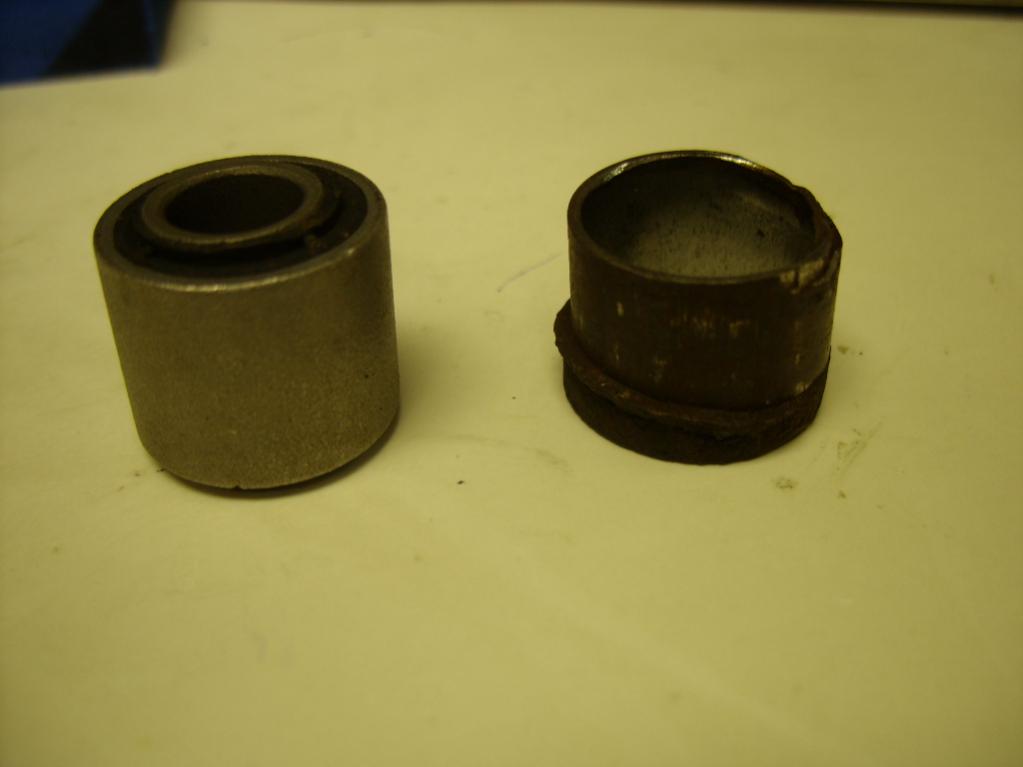

Thanks Bill. Here is how I finally got them out last night. After trying to press them out with no luck, I went to the old standby, 2.5lb mini sledge. I put a short piece of 1" pipe (close nipple used in home made all- thread bushing pusher) on the anvil of my vice, put the end of the sway bar on the pipe aligning it so that the bushing outer would be free to pass, place a matching size socket on top of the bushing outer sleeve, put a heavy washer on top of the socket, and gave it a whack! Pop, out came the bushing sleeve. One thing I found (see picture attached) that may help others with this problem is that MG installed the original bushings from the "outside" in. By outside I mean if you hold the sway bar it forms a "U". The bushings were pressed in toward the center of the "U". I had been trying to push them out from the same direction, with no luck. Fortunately when I put it on the vise to drive the bushing out the sway bar was too tall. Because it was too tall to rest on my vice, I turned the bar up toward the ceiling and was then driving the bushing "out" from the inside of the "U". After getting the bushing out I immediately saw the original problem was a large area of galling caused by the original installation on a large press. I could have never driven the bushing out in the direction I was originally pushing. At least their out now.
