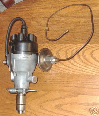

BOB! you have a PM check it NOW!!---Here it is see attachment. Regarding malfunctions of a timing light when operated in close proximity of the ignition wires: The timing light contains electronic circuits that may be susceptible to the radiated fields generated by the igntion system. These radiated electromagnetic fields can make the light malfuncton and they radiate out to significant distances away from the car.---Keoke- /ubbthreads/images/graemlins/yesnod.gif /ubbthreads/images/graemlins/hammer.gif
