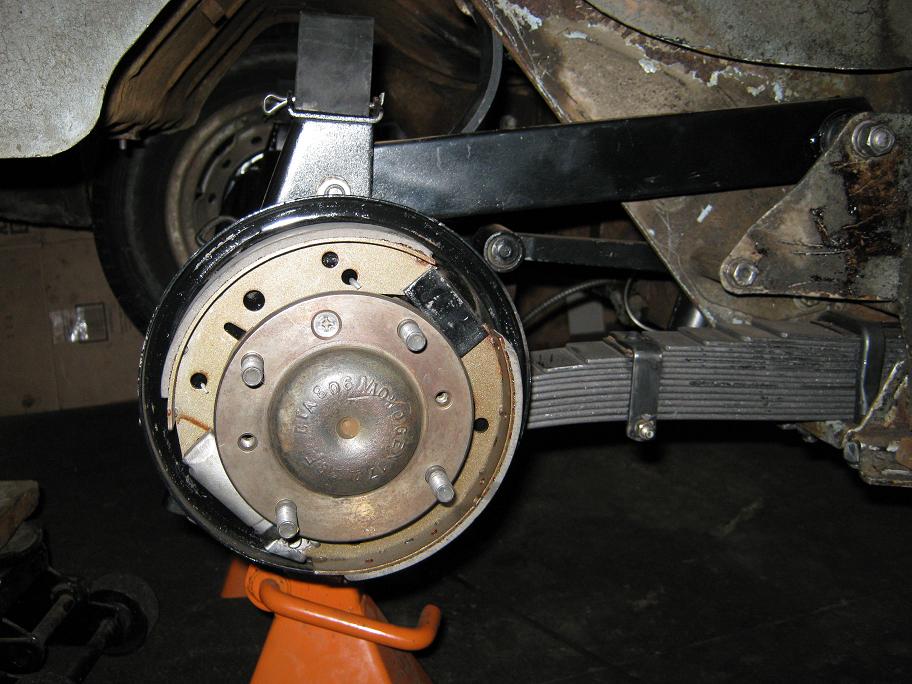

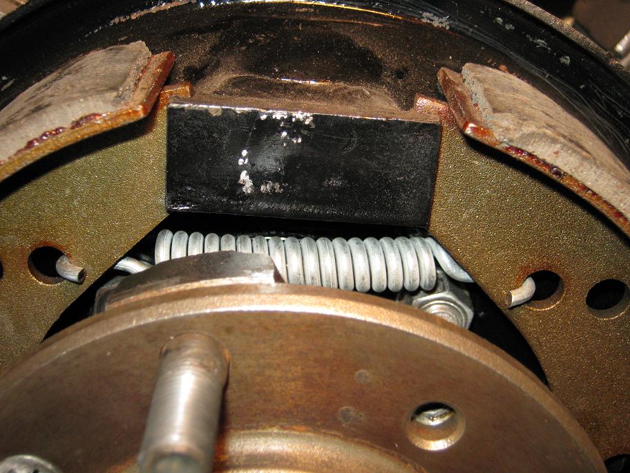

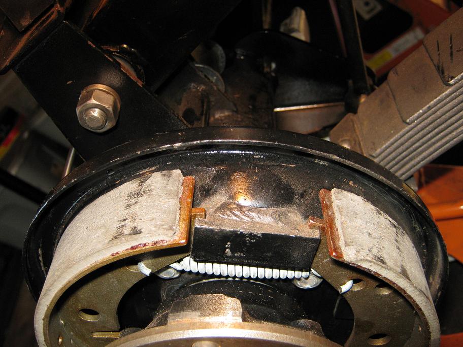

Now my issue. Rebuilt the rear axle assembly and installed new brake shoes. When I put the drums on they go into complete bind!! I've done brakes in the past, but have never experienced this much binding! Got the old shoes out for comaprison and noticed the new shoes are .046" longer per side then the old ones. I measured this at the pivot stop from the end of the shoe to the shoe frame where the lining attaches. Hope the pixs do a better job explaining this!! Has anyone else experienced this or am I trying to rationalize some other problem. My guess is the additional .046" per side is causing my binding issue.

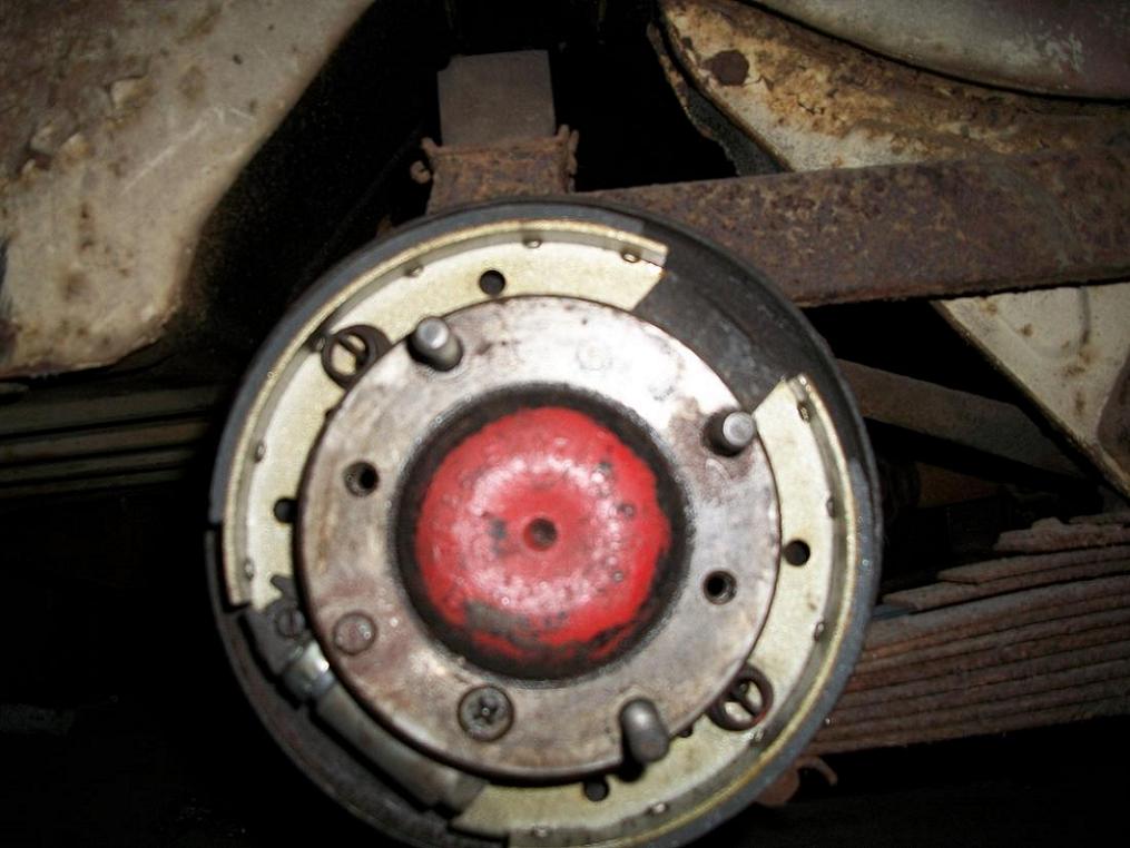

Are you sure that the spacing where the adjuster should be is not wider than stock? Here is a picture under the drum of my car.
Also the material on the shoes I bought do not come all the way to the edge.
I can get some for you tomorrow, I just redid mine, Is the adjustment thing(not sure what it is called) but the piece between the pads and the cylinder on the bottom, it looks like this can change the placement of the pads tremendously. I have my new shoes installed and the drums fit on there good, just need to get them cleaned up. If no one else gets a picture up today I will get one for tomorrow.
I am not expert on the brakes for the BE but I did just redo mine a couple weeks ago.
I'm beginning to think my problem is I put the adjuster in wrong. A pix would be great, thanks.
Here's my right brake assembly. I believe the adjuster should be flipped 180 deg.

"I believe the adjuster should be flipped 180 deg."
I believe you are correct. Rotate it 180.
Adjuster very difficult to reach in the current position.
It looks to me like your backing plate is in the wrong position. It should be turned 90 degrees counter clockwise, and the wheel cylinder should be flipped 180 in its slot. Adjuster should be on piston side of cylinder, and the piston side of the cylinder should be trailing.
Brian
Well just got back from the garage and yep, the adjuster was flipped 180 deg. Made the change and it works just like it should!!!! Checked the left side and it was installed correctly????
