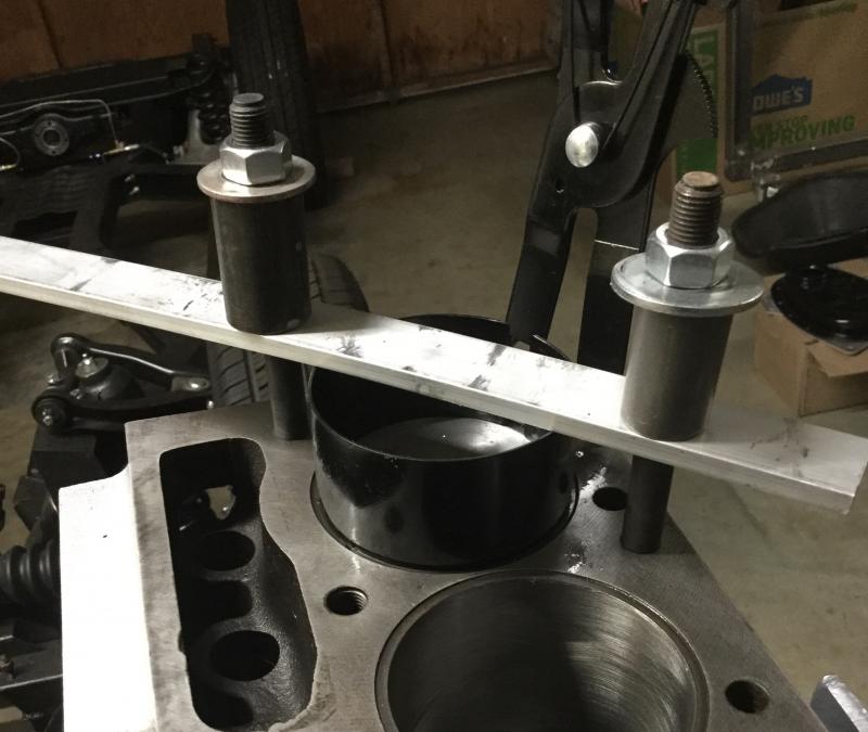

There is no possible way to get those pistons into the cylinders. Tried both can style and pliers style compressors. The latter is the way to go because my (cheap) can style compressor would rotate the ring gaps as I tightened it. Even with a decent pliers style compressor I could not keep that thin oil scraper ring from peeking out below the compressor and halting my progress.
Finally I got one installed with home made addition to the tool, picture below.

Rut, I had a text message ready to send to the machine shop, but decided to try the mechanical assist first, holding that compressor down so the bottom oil scraper would not pop out. Also had to fiddle with (grind) the bottom of the compressor where the squeezing mechanism is riveted/welded to the ā€œcan.ā€ It was so thick there that it was hard to seat it into the recess at the top of the cylinder... mine’s a ā€˜73.
