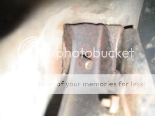

So I notice a creaking coming from the front of my new-to-me '74 TR6, and I've determined the noise is a loose front bumper (!). https://i125.photobucket.com/albums/p52/mrv8q/IMG_0525c.jpg shows one of the missing nuts from one of the main support brackets for the bumper. Page 56 of the Bentley shows:"Front bumper support bracket to chassis" as a 3/8 UNF.
Two things: 3/8 seems too small a nut, and is there a standard thread count? These are a nut buster to get to, is anyone familiar w/ these? Thanks!

I just looked at my old TRF TR6 Green Book, which shows all front bumper bracket bolts to be 3/8" diameter UNF thread along with matching nuts. There are a couple of different lengths, depending on exactly where they are, either 1 1/4" or 1 1/2". Both nuts and bolts require 9/16" wrench size on heads.
Hope that this helps.
Paul
Thanks, Paul, that does help. Dummy me, I didn't realize the 3/8 referred to the BOLT. The nut looked like it would 9/16 to me, is there a common TPI for these ?

Most of the threads on these things are UNF except if it goes in Aluminum.
The size you need is 3/8-24, I never have understood why the manuals don't just spell out the threads per inch specification.
