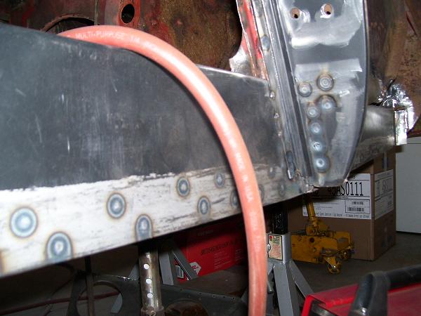

Installed new inner sills. Used a spot welder to put the 2 halves together. Added new pieces to the hinge pillar and spot welded also. Replaced door shut with all new pieces also. Did these repairs before soda blasting so I didn't lose any locations when tossing frame around. Will post another pic on next post. :hammer:
