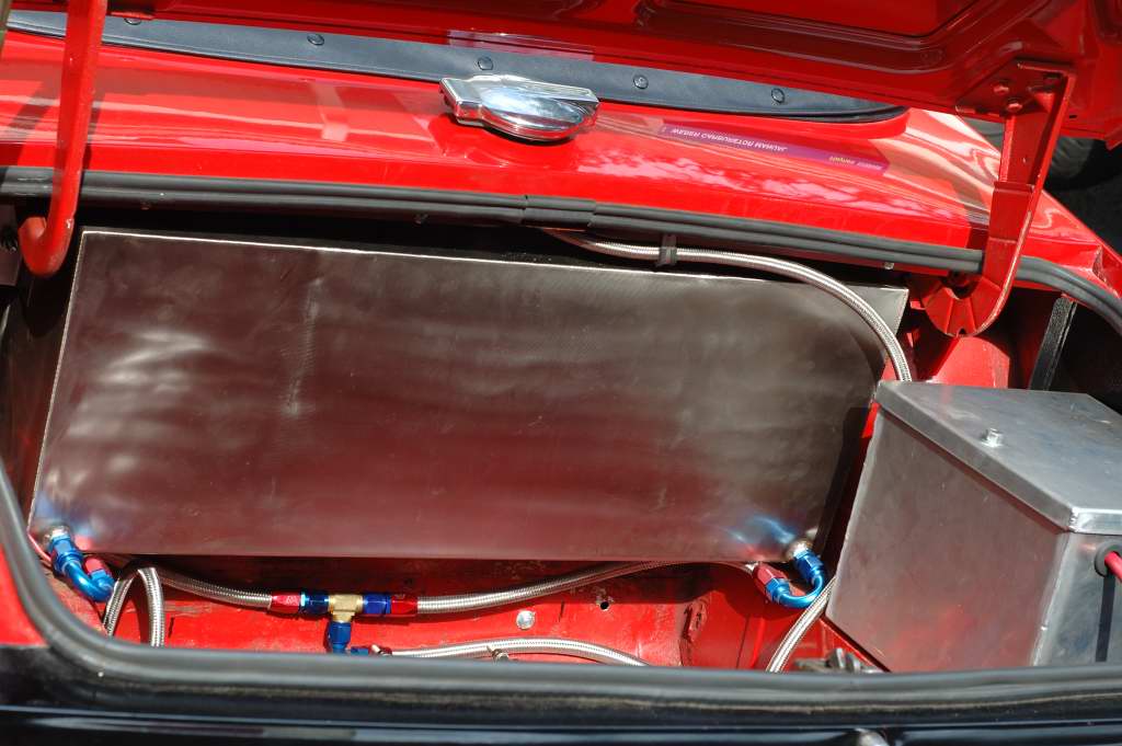

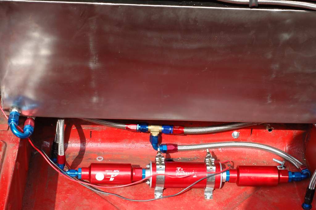

Gratuitous EFI pump shot - No spare tire for me...

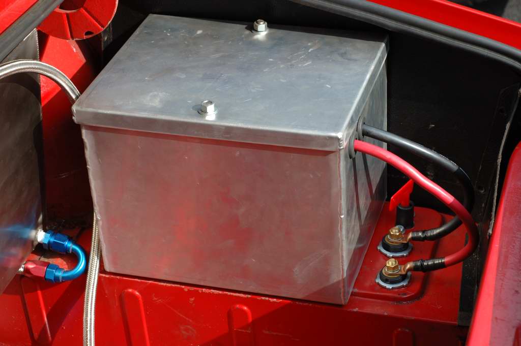

Battery cable shot - I relocated it to the trunk and used some Moroso through bulkhead fittings to run the cable - which as you can see is plenty thick enough.
The battery box is a $50 job from ebay. I actually think it turned out pretty well.

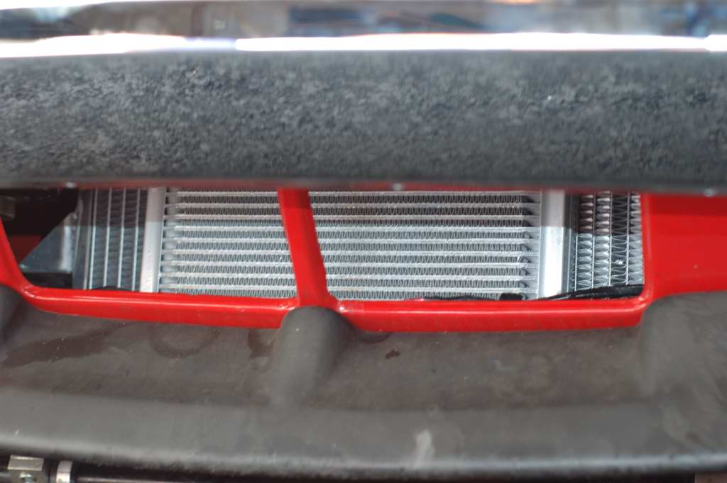

Spin on oil filter using a sandwich plate as a thermostat. It's an SP1T Mocal type. I like that there is only two (instead of the usual four) lines to the cooler.
Its hard to see, but I couldn't get the camera down in there.
kudos to alansimon for the original idea...

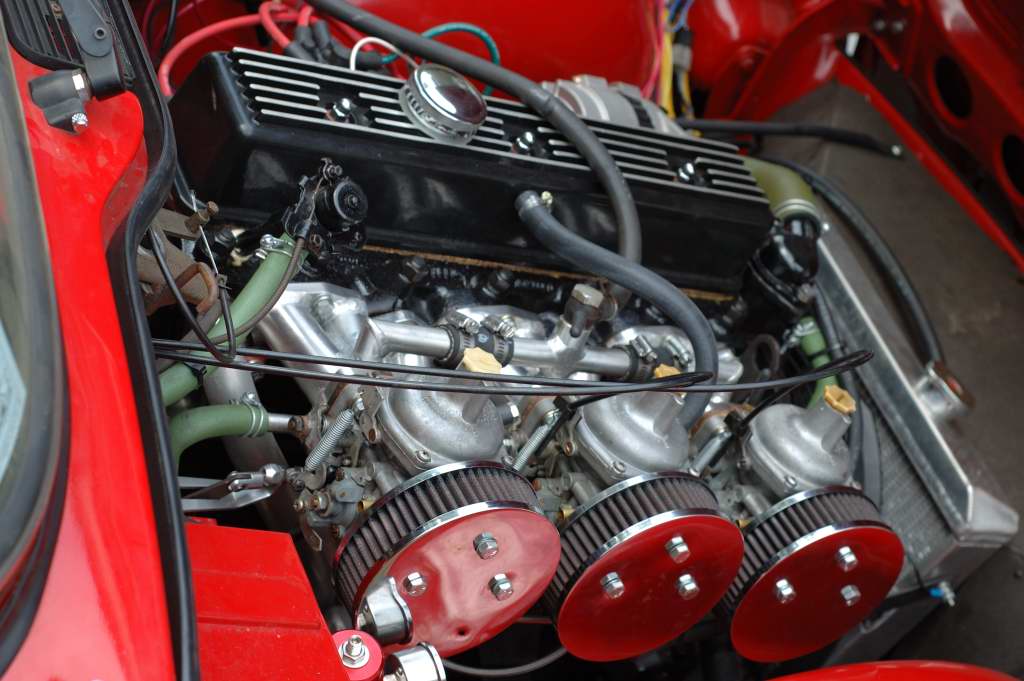

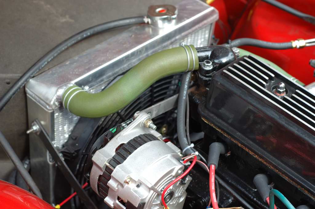

Stainless rad and 85A alternator.
Thats probably enough for now. I'll post a picture of the rear halfshaft setup next time I take the back wheel off. It looks really really neat in there. Works great too with the LSD. Tried it this morning...
