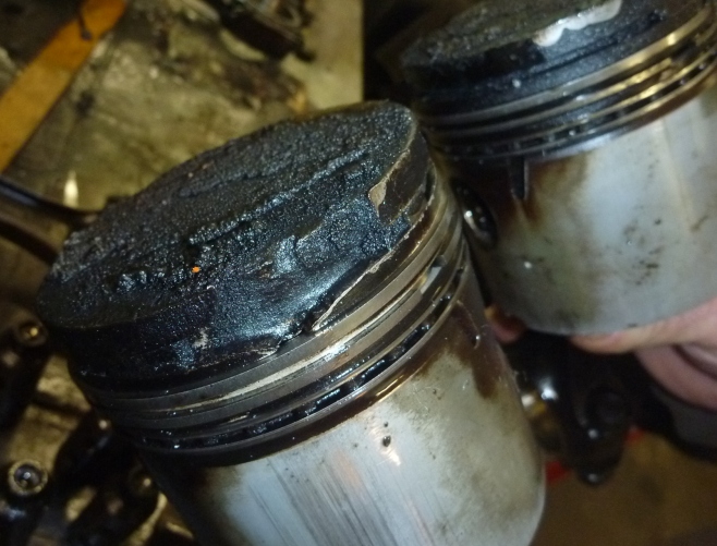

My two pistons with oil-fouled plugs - it's amazing how well the car ran like this. Makes one really appreciate how robust the Healey engine is:
Some of the rings were in 1/2" chunks. The bores were fine - no ridge and no vertical scoring.
Am installing .060" overbore Venolia forged pistons with a DWR8 278 degree cam.
PS - Venolia in Long Beach turned the order around in 2 days!
Did you have a ticking sound, valves hitting broken piston rings on top of the pistons?
That's scary. To think that one could buy a Healey thinking that it ran well, when it really needed a rebuild that badly.

My mechanic, Russ Thompson, says pistons in a shape like mine are common in LBCs, especially MGs.
I bought the car in 1999 so who knows if the pistons were like that then?

Ray - it hasn't turned out yet. The engine has been dismantled and hasn't yet gone to the machine shop.
It smoked a bit and the bad cylinders had 120 psi when I checked last summer. I had done a dyno run a couple of years ago at 93 bhp - which was the same as a friend's stock 29D having been rebuilt in the '90s.
Before I traded up I had a Frogeye. I rebuilt the engine on that after going through eight pints of oil on a 150 mile motorway blast (the clue was the oil pressure going to nothing as I pulled off the motorway and slowed down - dipstick wasn't long enough to reach the oil). Anyway I filled her up (with oil) and drove another 500 miles or so before the rebuild - after all it was only smoking a little and running quite smoothly! When I rebuilt the engine only two piston rings across the four cylinders remained completely intact.

My first Healey got 25 miles to the quart when I bought it. The pistons looked like that when I pulled them out, but the bores were fine.
I assume the iron block can withstand much more abuse than the aluminum pistons.
