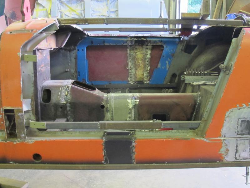

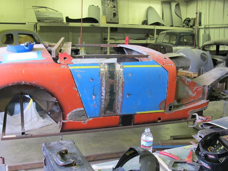

bugeye LWB 2 001.jpgSo here is the Sprout in process, bugeye LWB 2 003.jpgGot the idea from Bugeye Guy's Youtube channel

That is a great idea adding a few inches to the length of the car. As I do not work on Sprites my self I am not sure if they have a separate frame. If they do how did you address that?

The Sprite has no frame. I don't know if it was the first unit-body car, but it was at least one of the first. The area that I chose to cut and lengthen is all flat steel or simple curves. No compound curves means I can add the sheet metal without special metal-working skills. Bugeyeguy says the extra length actually makes the car more stable on the highway.
