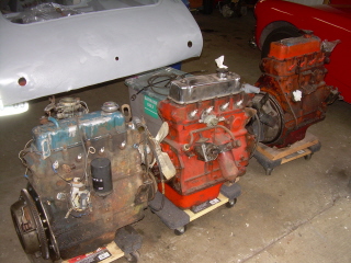

Pictures of the Datsun J15, an MGA 1600 and an MGB 1800 3-main:
I think that it is attached-

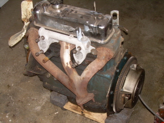

Here is one of the J15 dressed-up as an MG engine:
Bill
