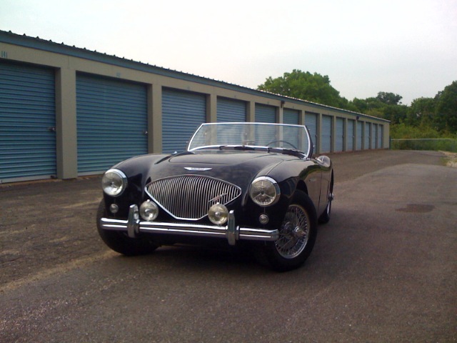

Ok. I have another question..sorry if I am being a pest.
I just got my 100, and if I look down the side of the car I can see many what look like tiny dents. Like if a 20 loose shopping carts came and hit the car. The thing is you have to be looking at it in the right light and in the right angle. 5 feet away you can't see them.
All body panels are original. Is this normal for a car of this age or signs of poor body work throughout the years?
With that said, can I ask what a 1956 100 would be worth? Let's say tip top condition .. not Pebble Beach, but what would look like a show winner to the average person. (Just want to compare)
Thanks again for all your help and I'm sure I'll have more questions.
Here's the car 5 feet away .. looks awesome.

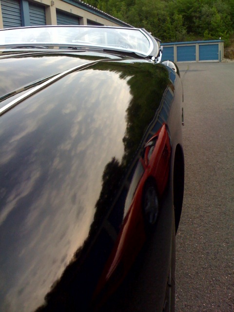

This might help with what I'm talking about. You can't see the little dents in this picture, but if you look at the reflection, the roof line of the building is wavy, because of the small dents.

There is nothing...nothing like a Healey with the windshield folded down... man!!!!!
You're right. It does look nice except for the dents. If they are on the horizontal surfaces only, it could be from hail damage. Also possible is damage from previous sandblasting to remove old paint. If the black is the original color, everything, engine compartment, interior metal, all under fender & panels, frame will be black like the body. Paint, not undercoat.
A "good" body would not have any "dimples". I've not seen one with paint that nice that had dimples.

The paint would probably be very expensive to fix right, although because you can get behind most of the panels you might ask around and see if there is a good paintless dent removal guy in your area, the good ones can do wonders, but there are varying skill levels.

..., but if you look at the reflection, the roof line of the building is wavy, because of the small dents.
Hummm. Dents? No, but did you notice that someone painted a big red Ferrari on your quarter panel.
The wave on the top of the panel, near the chrome trim, is due to the panel bolts being incorrectly installed/tightened. I have the same issue with my 3000. Drives me crazy when I sight down the fender. But, with a heavy application of the throttle all is temporarily forgotten.

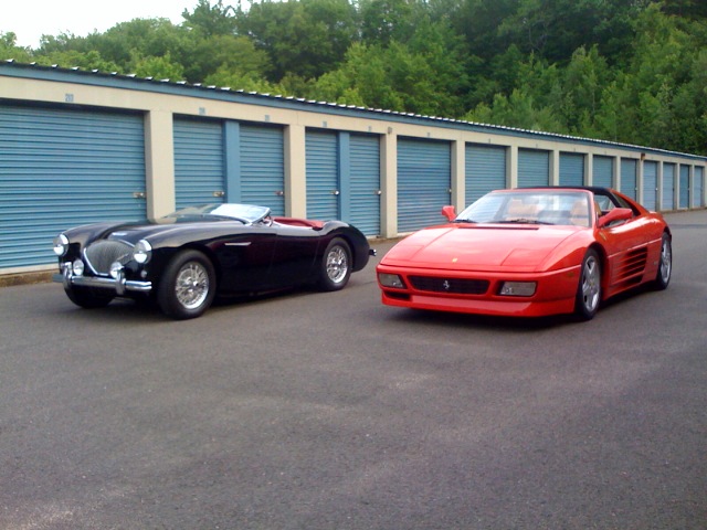

Thanks Dean. Yeah maybe I'm being too harsh. Although it's nearly impossible to see in a picture. It's all I can see now .. but you really do have to be looking for them. Man the car is fun .. as is the Ferrari. The throttle response is very different on the two cars (as you probably could have guessed). I'm glad my garage is under construction so I can't stare at the two all day. I wouldn't get any work done!!
Attached is a pic of my two girls.

Sorry, but I think most of us would want our car to look so good. I don't see the problem unless you are looking for a princess and don't care to enjoy the driving of these magnificant machines.
Ha! Thanks. I can't stop driving it since I got it! I do love it and I don't want to sound like a baby about it. I'm just trying to gauge if these "dimples" are acceptable for the price I paid for it.

Plus of course black is the least-forgiving color since it is the most reflective car color, exaggerating every little imperfection.

Yeah thanks for the comments glemon. Funny that you said that about the picture of the Ferrari with the Healey. How awesome is it that the Austin Healey is a sexier shape than a Ferrari! I think that just speaks volumes about what an amazing car this is.
