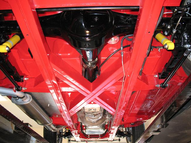

Anthony7777, Pic #2 in the write-up shows the attachment for the top of the front Bilstein shocks and Pic #3 shows the attachment for the top of the rear shocks. Maybe I'm not understanding the question. For the front Bilstein shocks the front two bolts of the stock shocks are replaced with long bolts and spacers to attach the new brackets. In the rear, the bracket for the Bilsteins attaches to the original shock mount.

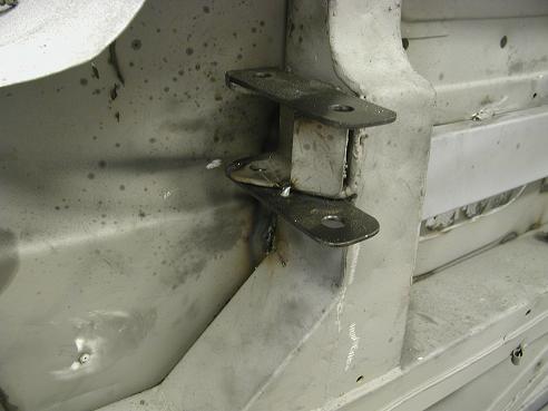

Great account of your suspension and steering improvements on your web site! As I have said before, you web site is as well engineered as your car. Did you custom make the forward mounting brackets for the control arms or are those BJ8 brackets used on your BJ7? Having a BT7, I am not familiar with the BJ8 bracketing. I do like the addition of the control arms.

Steve,
How did you arrive at a choice of bilstein model? as I had them on my beach buggy but took them off due to their being too stiff for the weight of the car, ended up back with stock shocks due to them not having a softer choice, does bilstein now have a chart to use for choice now?

The forward mounting brackets for the radius control arms were included in the Cape International kit. They're welded to the stock front spring attachment point. (Pic shows brackets tacked into place for inital fitting.) The BJ8 control arms attach above the spring, rather than below as seen here. To attach the control arms above the springs the BJ8s have modified the sheet metal with pockets for the attachment points. I considered retro fitting the BJ8 methodology, but in the end decided the CI approach was the most practical.

Zblu, Udo Putzke takes the work out of that. He works for Bilstein, I'm not sure of his capacity. He has Bilstein revalve these specifically for the Healey....best I can tell driving it around the neighborhood, they are a great match for the car. I think Lin has Putzke's Bilstein kit on his car, maybe he can chime in with his opinion of the kit.

and look forward to further info on the shocks, are yours adjustable?
Great looking rear suspension,got konis on my '63-BJ7, didn't put rears on, left it stock(new).I've seen& worked on them w/konis in the rear& seen brackets pulled through the sheet-metal. This,plus radius rods looks much better. Very clean app. Cheers
Tube versus good rebuilt levers by Peter at world wide auto parts has been debated over and over again. I really don't know which is the better route. I do know that I like my Bilsteins. I think Udo got the valving right! Kudos to him.
