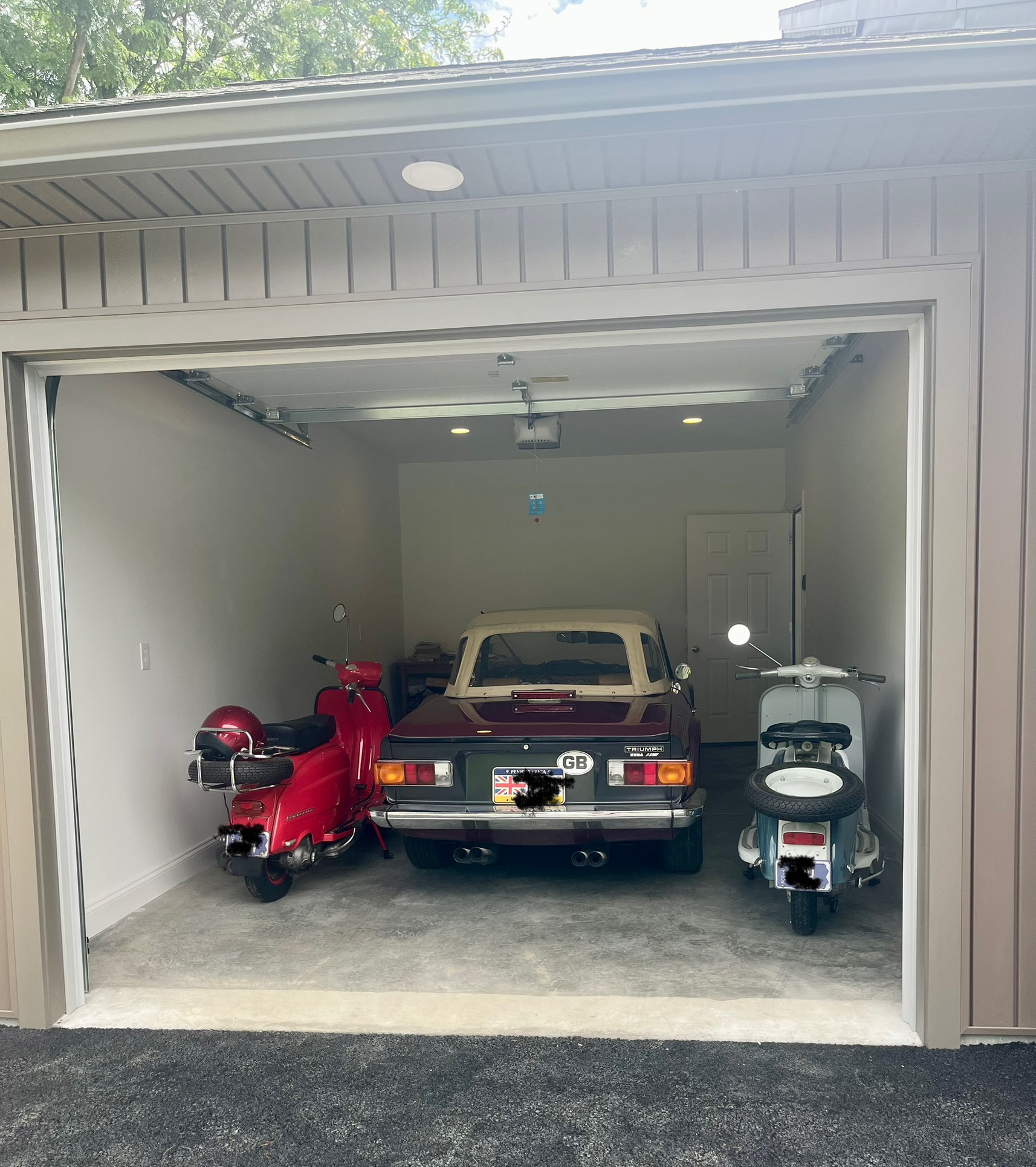

I added an additional garage and storage space onto my house. Now my TR6 and his Italian scooter friends have their own garage and that lets me park my daily driver in the open garage.
Also installed new garage doors and paved driveway.
Looks great! (but you need to clean off the dirty license plates ...)
I have a bottle of pixel cleaner that will take that dirt right off.
Very nice! What are the badges underneath the “Triumph” badge?
Edit; I think I see it now: you have the 5sp conversion…?
You have a sharp eye! Yes, it’s a 5-speed conversion. I put the badge on the car to honor Herman van den Akker.
