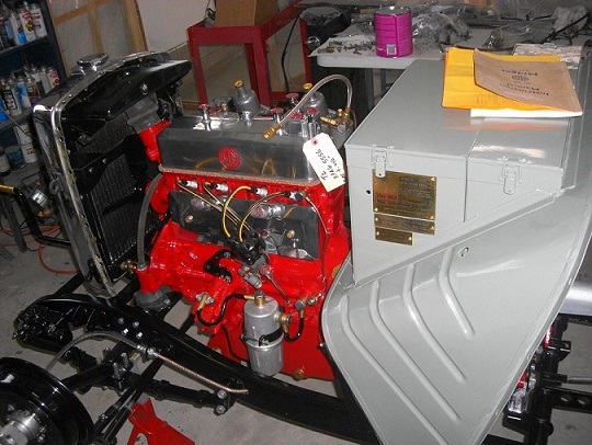

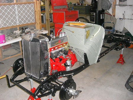

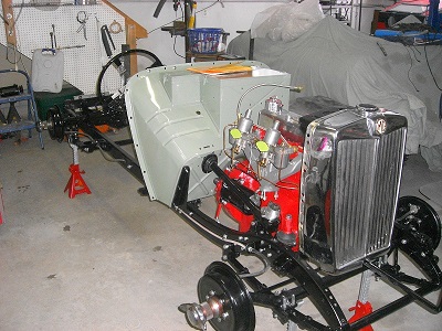

I last drove my TC August 11 , 2012 when I was in a bad accident with it. A young man coming toward me and late for work , turned left immediately in front of me at an intersection and I could only manage to not hit him head on ! Nobody was hurt . The TC wasn't so lucky ; I bounced off his right rear quarter panel , bending the entire front end sheet metal to the right , twisting the steering shafts and linkages, bending the springs and the frame extensions and pulverizing the valance ,badge bar, spot light. Even the gallant little engine stopped instantly , its fan blade tearing into the radiator !
I didn't touch the TC for months.
I started restoring it exactly one year ago . This is where I'm at today with the chassis.
Rather than find a replacement chassis frame , I opted to straighten this one using the factory dimensional diagram in the owner's manual and my skills and ingenuity. I pulled , pounded , heated , welded , and measured until I was unable to see or measure any deviation from straight or square.

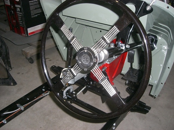

Every part has been cleaned , inspected , replaced or restored to the best of my ability. The original Bishop steering box now fully rebuilt and fitted along with all new tie rods, ends, king pins, bearings, etc. works beautifully.
I've got all the bodywork finished on the tub and outer panels and am in the the finishing stages of primer work.
