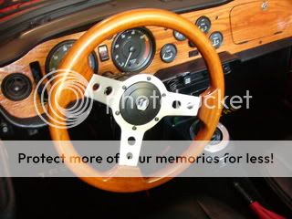

Trying to verify if the steering wheel on my car is a Mountney or Tourist Trophey wheel. The screws that hold it to the hub on mine measure 4" from center of top screw, to center of bottom screw, with a 6 screw pattern.
Mine has no name on wheel or hub to verify brand. Does anyone have that brand wheel and could verify measurement? Thanks.
I have a Mountney, (6 screws, exactly 4" apart) and it has stamped on the center spoke, "Mountney: Great Britain", I can't speak for what a Tourist Trophy has on it.
HTH
The mountney I have has the name on the wheel at the bottom. istr it looks pretty hard to get rid of it. your wheel looks 'chunkier' than mine, so at a first guess I'd say you don't have the mountney - or at least not the one I have.

No the wheel isn't harder to turn, and yes it gives a bit more thigh room. This wheel was on the car when I got it and for all I know could be 20 years old or more. Thanks for the measurements as 4" x 6 screws seems to be the odd size compared to Momo, and other brands.
The problem I am having is a wierd one in that the hub for the wheel is made of some lightweight alloy and has worn where it slips over the steering shaft spline to a point of needing replacement. The wood dash matches my wheel so I would like to keep the wheel and replace the hub, so the measurement help is priceless. I will now hunt down the Mountney hub.

I was guessing a 4" when i posted, I found a metric ruler and mine is 100mm. Thanks for the follow up. It may or may not be a mountney wheel but seems to be the Mountney pattern. I emailed a couple of UK dealers to verify, and hope to hear from them soon.
