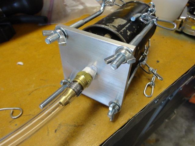

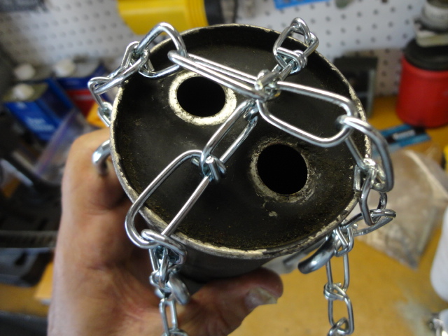

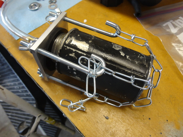

Out of desperation I purchased this contraption. You can imagine what a bear it was to try and install it and what the results were!! I'm going to take the Motive Cap I purchased and use a Dremel tool on it like Ed K. did. Forget trying to get the hose adapter in this country for it. They're foreign as in Germany(I've been told).
