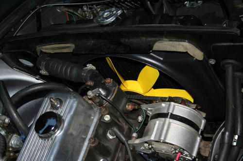

Added this to both my cars and both times the results have been great. https://www.mossmotors.com/Shop/ViewProducts.aspx?PlateIndexID=37145 Moss claims it is for the earlier cars but it fit both my cars with no mods to either the car or the shroud.
My 75 went from running in la traffic jams in the summer about 2 to 3 needle widths to the right of the N is now at or to the left of the N while sitting in 90+ degree weather.
My 73 which has always run warm in town and cool on the highway previously was 1/3 to 1/2 way between the N and the H is now running at the N in town with no change on the highway temps.
Installation is very easy and is less than an hour job. Basically remove the radiator from the radiator support test fit the shroud and with the shroud in place reinstall the radiator and once the shroud is clear of the fan do the final tightening and your set.

Why does it say in the ad, 1962 to 1967 and shows no other years available when the radiators are the same from 62 to 76?
The radiators changed when the factory installed the pollution pumps. The filler went from behind the shroud to the front and the top hose connection changed sides. But if it works it works! Never actually tried it myself. Bob
