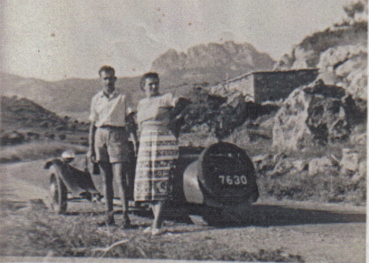

Thought you Morgan chaps would enjoy this old pic from the early 50s. That's Mom & Dad. I used to ride in the 3rd seat (over the chain drive). We had this car til I was about 6 yrs old!

wow. great pic - thanks!

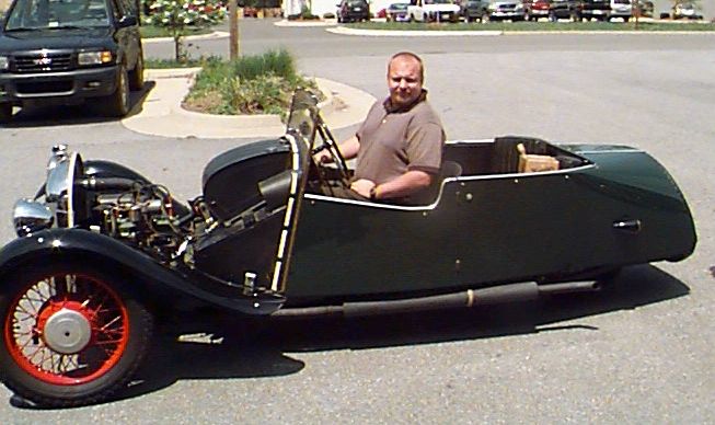

here's another. this one is an f-type "family", 100e engine (look ma, no water pump!) 4-seater. Fun to drive as long as you don't try to go fast.

I saw a few Morgan trikes back when I lived in Ontario for a few years, but have been dry on Morgan trike sightings since moving back to Alberta... They are definitely very neat vehicles...

That is a nice picture. Looks very similar to the old pic. I posted, though I am positive ours was a 3 seater. In looking at yours I was struck by how the spare was mounted on my Dad's car. Yours looks right and his wrong. I wonder why they would have mounted it high like that? What was the power in yours? If I recall correctly (and I probably do not!) ours had a BSA engine, does that sound right?

There were more variations on trikes than... well, there were a lot.
Looking at your pic, it looks like the body is lower - rather than the tire mounted high. Could have been a variant from the factory, or a mod from an owner to reduce the center of gravity.
usually the 4-seaters had a tiny seat on either side of the rear wheel arch. I'm guessing someone (again, maybe the factory) modified the wheel arch to provide a single seat big enough for a 10-year old. <grin>

anything is possible, if not from the factory, certainly by the morgan enthusiasts of the time. BSA was not a popular engine in Morgans - Matchless and JAP engines were the most common twins, hung off the front of the car in the airstream. If it had a front grill and bonnet, it was probably a ford 100e engine - like the pic I posted. It had about 10 hp. It was water cooled, but used convection to circulate the water instead of a pump. Of course, there were all sorts of performance upgrades for the 100e engine, most notably the aquaplane head and carbs. heck, there were even superchargers available.....

That is gorgeous!! In hindsight Dads' (which was blue) must have had the Ford engine, as it certainly was water-cooled! This thread certainly does bring back some fond memories of that car...Thanx!!
