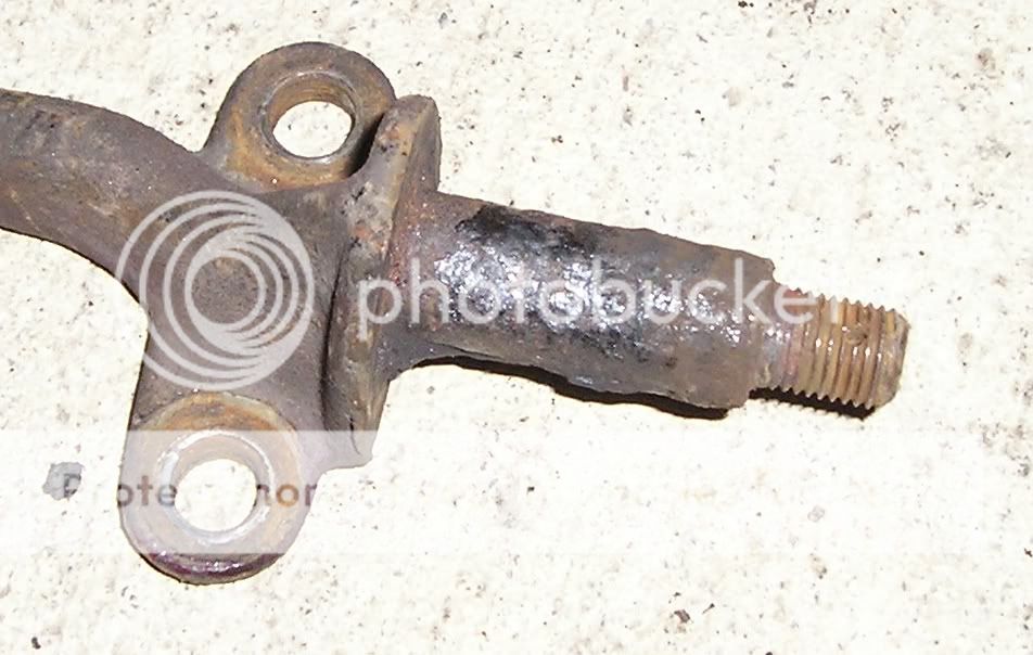

Not to beat this topic to death, but here was my just removed fulcrum pic:

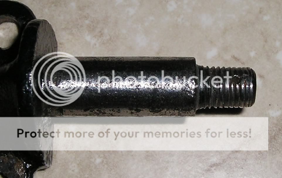

Here's what it looks like cleaned up and painted (I painted the pin then took the paint off):

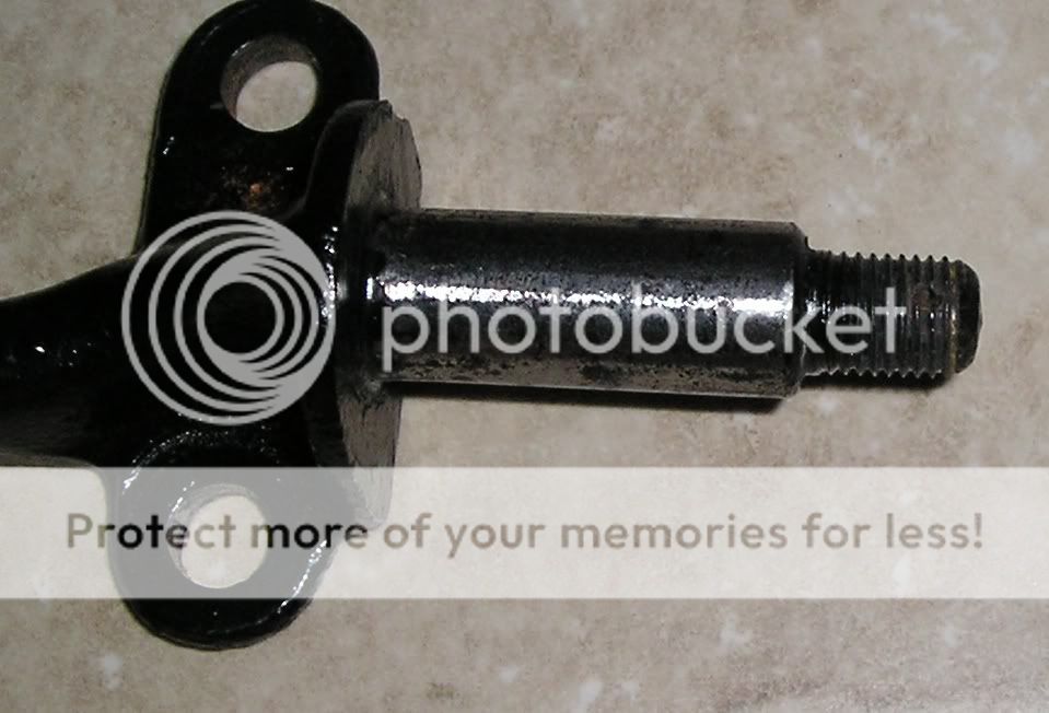

and here's the side I stripped:
Is it worth tapping new threads, or should I just go with a new one from TRF? Or should I buy a used one from the local TR mechanic?
Mine looked like that when I removed them too and I figured that the amount of rust penetration would fatigue the structure enough to warrant replacement. I bought new.
