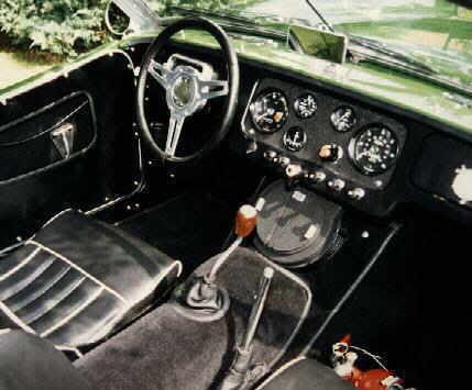

Oh....Here's one for you.....Heater I mean.
The round thing in front of the shifter is the heater....
You just open the little doors and the air comes out /bcforum/images/%%GRAEMLIN_URL%%/grin.gif
(If you get too warm....You close the little doors....Gloriously simple)
The whole thing weighs as much as a box of Kleenex.
(But it was optional and didn't come w/ my car)
