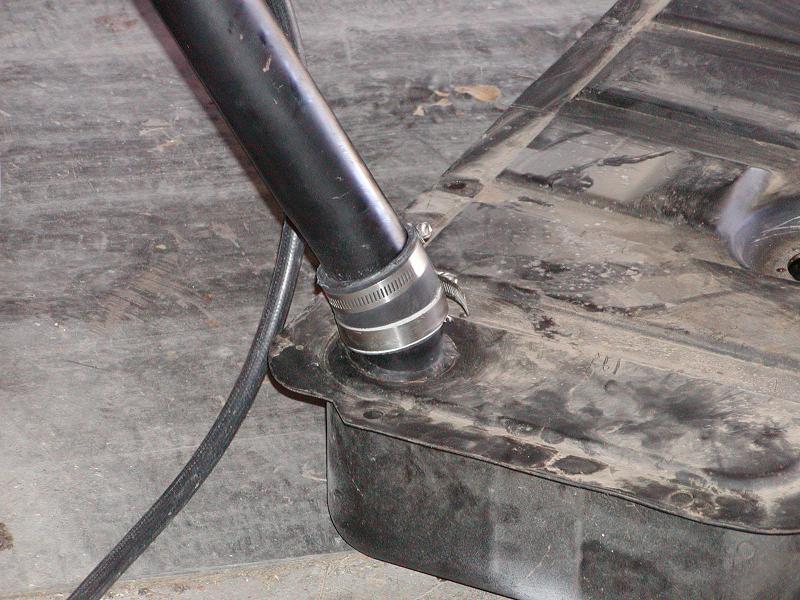

I had a Friday afternoon made tank. Fixed the issues with the fill pipe when doing the body work. Also cut slots in the fill tube inside the tank to get the rest of the tanks volume back. Pipe extended 1 1/2 inches into the tank and the gas cap would only go on with the palm of your hand. Been fine so far. And a breeze to re-install..
Works fine and lasts a long time. We often overthink this stuff.
