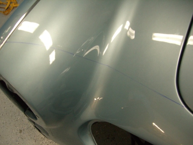

From photos I've seen of your Healey's, you seem to keep them in beautiful condition. How does the paint on the front of the Healey hold up on the race track? Does the paint get chipped much? Do any of the racers install a clear bra, to keep that from happening? I put it on my car right after my restoration and it has keep the front end, chip free. (Second photo shows the marker outline where we are going to cut the film.)
I do use this subtle 4"size of https://www.griotsgarage.com/product/protective+shield.do?sortby=ourPicks
along the front bottom and sides of my race. Unfortunately the damage I encountered last year was a little more severe (Healey Marque September, 2011). I think most vintage racers just accept the rock chips until they're bad enough to get them repaired and re-sprayed. Others just see them as "a badge of honor".
