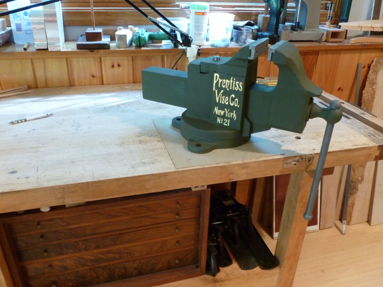

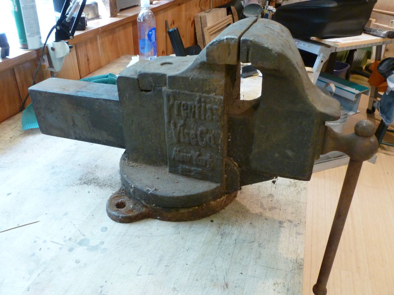

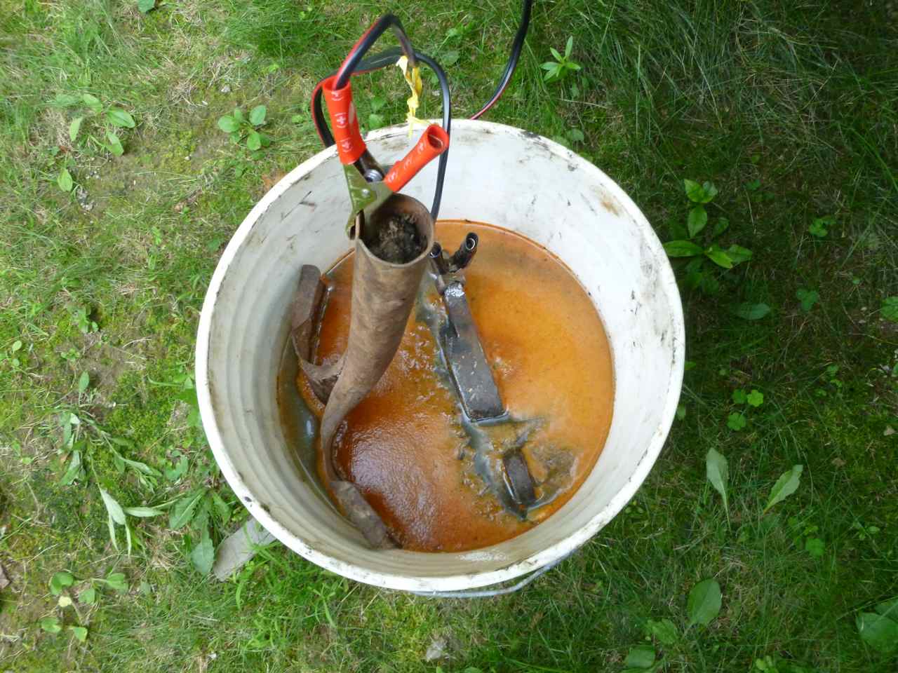

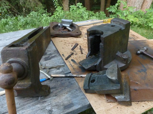

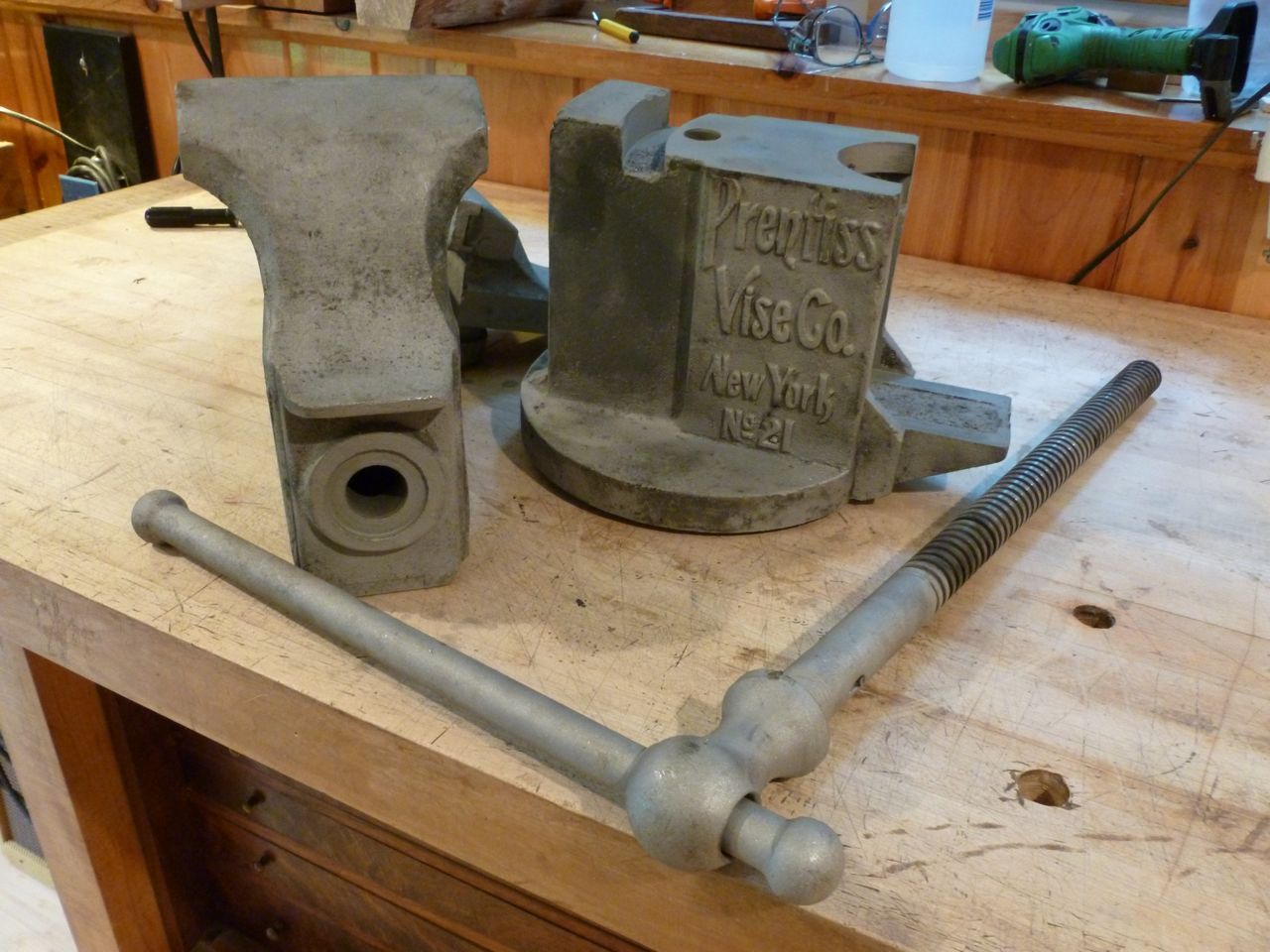

I rescued this vise over the 4th of July holiday. I love this thing. It's literally 109lbs of American Iron. From what I can tell it was made between 1890-1922. The Prentiss Vise Co only made two models that were larger at 160, 230lbs. (now that's mucho grande) It was rusty, the base and rear jaw were frozen. It was generally impacted with dried grease and wood shims. I disassembled, de-greased, and began de-rusting with battery charger/sacrificial anode method. While that's always fun, I was glad when a friend with a sand-blasting cabinet (at work) bailed me out. After that it was metal prep and paint with o.d. green. Then a little wax and grease on sliding surfaces. To finish it off, I highlighted the letters with gold leaf - out of respect for the skilled men who used this beast before me. Reassembled and now I'm looking for something to crush! :banana:

Now THAT is a cool restoration!
Well done!
That is really sharp! I love to see things like this restored, instead of heading off to the scrap yard. PJ
great job Steve, btw what is the wood on the toolbox under the bench,
Very nice work, Steve. These old vises are great, and will last for generations to come.

It's Black Walnut. I sawed the drawer fronts from one board to get the figure to line up like it does. It's the toolbox that North Bennet Street School has their cabinet makers build for a first project. Even though I was in another program I figured I should make one too. Secondary wood is White Pine, all hand cut dovetails.
