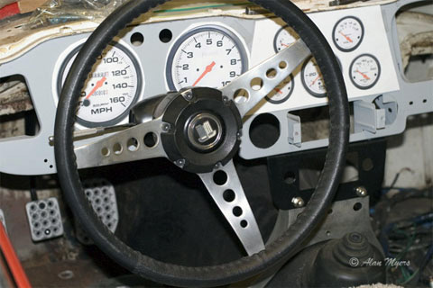

The reason I ask is that my TR4 currently has an early TR6 steering wheel, hub, horn button and button surround installed. I need to replace the steering wheel (it's bent). But, I'd like to keep the hub, horn and finish piece, if at all possible.
I notice Momo and Nardi steering wheels bolt up to their hubs with 6 bolts, and the bolt circle appears (judging by eye) to be similar to the TR6 hub/wheel.
I'm just wondering if anyone can tell me if these are a direct fit: Momo/Nardi wheel to early TR6 steering wheel hub?
File attached shows the TR6 wheel/hub/etc. installed in my car (please ignore the mockup gauges taped to the dash ;-)

Hi Shannon,
Let me explain a little further...
Under the horn button trim on your steering wheel there are 6 mounting screws, that hold the wheel to the hub. I was wondering if they are the same mounting pattern as the original, factory installed early TR6 steering wheel/hub. In other words, I thought maybe the Nardi (and Momo) wheels will bolt up directly to the TR6 hub, without a special adapter hub. I've got an early TR6 hub (and steering wheel) mounted on my TR4 right now. The hub fits well, horn works, etc.
Many steering wheel manufacturers use their own special pattern and require an adapter hub. For example, Grant uses a 5-bolt pattern. Moto-Lita uses a 9-bolt pattern. I'd like to avoid an adapter hub, if at all possible, but could use a new steering wheel. I've used the TR6 hub/wheel on my car for a number of years, but after a crash some time ago, it's bent and egg-shaped. Straightening seems next to impossible.
Early TR6/late TR250/5 steering wheels do show up occasionally on eBay and would make for the easiest swap, but are pretty scarce and are often beat up. For that matter, I'd rather see a really nice one used to maintain the originality of one of these cars, rather than used "incorrectly" in an older car like my modified TR4. So, I'm exploring alternatives.
Early TR250/5, TR4/4A and earlier original Triumph steering wheels are mostly "banjo" style and look great in the cars, but aren't very strong. (I've got a broken one in my spare parts collection. BTW, an optional wooden-rimmed wheel was offered in the TR4 factory spare parts catalog.)
Beginning with TR250/5 there were factory steering wheels with flat metal spokes offered. These are stronger and generally safer for vintage racing and such. Looking at the pattern on Nardi and Momo wheels (and a few other brands using the same) it appears to be very close to the early TR6 bolt pattern. So, I was just hoping someone here would know if that's true. Alternatively, I might find a local Momo/Nardi dealer, take my old steering wheel and compare.
I'm limited to a leather-covered wheel, not wood-rimmed. Many racing venues prohibit wood-rimmed steering wheels. Plus, my car does not have a wood dash, so plain, black leather simply looks better.
In my car, to me a 14" or 15" wheel with little or no dish seems ideal. If Nardi or Momo or other brands usingthe same pattern would happen to fit, there would be lots of sizes and styles to choose.
Thanks in advance for any info!

Alan,
My Nardi is bolting up directly using the single bolt; there is no adapter. The horn even works!... most of the time anyway.
