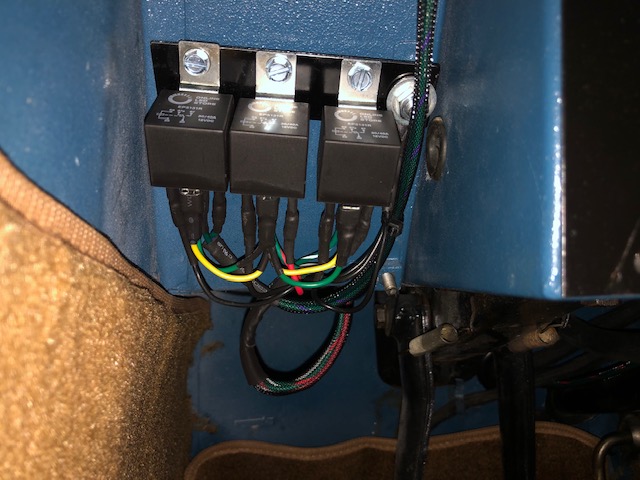

Fast forward to the Winter of 2019 as I am ending my driving season. I decided to try to modify the rear again. This time, I found a thread about using relays to combine the functions. I began a private discussion with Randall (TR3driver) that probably drove him crazy. He was very patient with me answering all my questions, just like he does on the forum every day. He sent me a schematic of how to wire the relays and where to interface the car wires. I mounted the relays (typical auto relays, 5 pin SPDT from online LED Store via Amazon https://www.amazon.com/ONLINE-LED-S...pin+relays&qid=1586614541&s=automotive&sr=1-3) on a piece of strap attached to one of the bolts holding the brake and clutch master cylinder box in place next to the pedals in the cockpit. I chose to use the correct color wires sourced from 4RCustomWire https://4rcustomswire.com/products/16-gauge-gxl-wire-individual-green-striped-color-and-size-options . I wrapped the wires in poly mesh sleeving, from McMaster-Carr https://www.mcmaster.com/9284k612, also Randall’s idea.

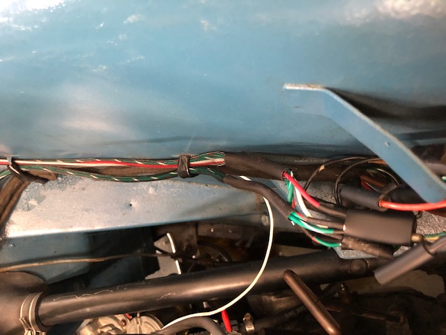

I had problems choosing the correct interface wires on the car. Randal, again, suggested using an old headlight as a “current limiter” when using the battery to trace circuits. For some of the circuits, I used a long pigtail and my ohm meter. I also had a problem understanding how the turn signal control head worked and interfaced with the flasher unit. The diagram in my Haynes Manual was useless. BCF regular, Marvin Gruber, who last restored this car, suggested the colored wire diagrams from Advanced Wire http://www.advanceautowire.com/tr24a.pdf. They gave me the knowledge I needed to finish the project.

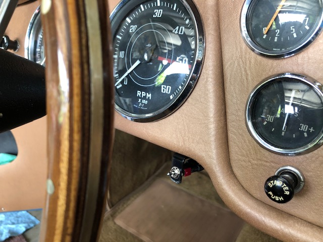

But wait, there’s more! The right blinker circuit of the control head had a fault. After much more research on BCF, I gave in (gave up on tackling the removal and repair of the control head) and bought a SPDT on-off-on micro switch from StewMac https://www.stewmac.com/ who specializes in guitar making. I mounted the switch under the front edge of the dash.
