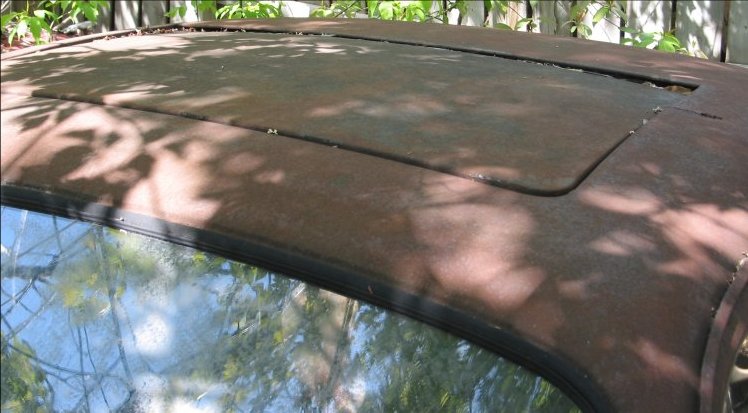

As noted above, the 1959 model has a sliding metal sunroof. The opening for the sunroof was cut smaller than required and then folded or pressed inward to create a smooth inside edge of the proper opening size (photo 1- taken from front of car). All additional panels, brackets, etc. are spot welded as opposed to tack or seam welded and painted the original body color. The frame of the sunroof is a channel approximately 1.5 x 1.5 inches in size on all four sides. Each corner of the frame has a drain tube that continues down the “A” posts and “C” posts through the floor to drain away water. The frame has a wooden piece attached to the front and the corner piece that the drain tube passes through has been flanged to avoid cutting the rubber tube. The headliner rods have been shortened on the sides. Although not much remains, there is some leather trim around the interior opening. This is the same color as the upholstery. It appears that all the bits and pieces came straight from the MK9 line . In other words, if this modification was done outside of Jaguar, it is one of the most professional jobs I have seen.
