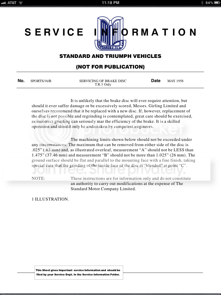

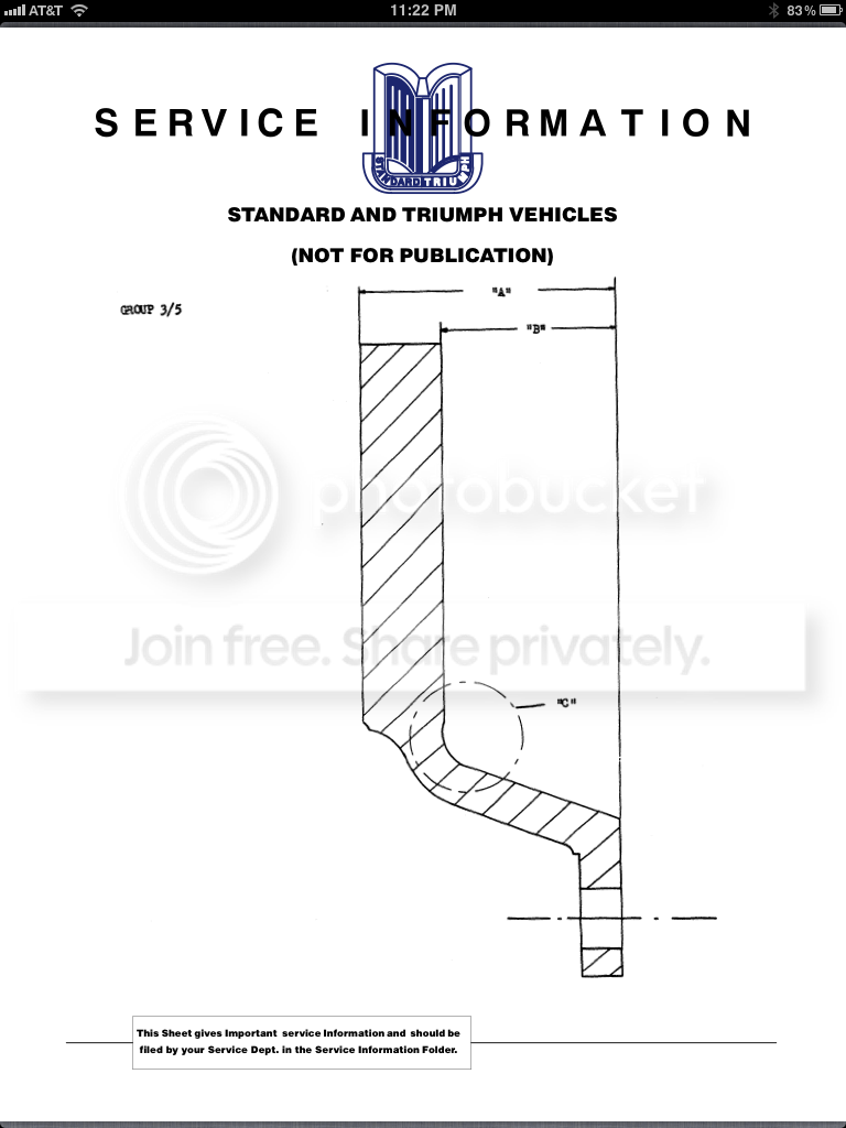

I was studying the bulletins and came across this...
If you subtract the two numbers above, you get 0.450 instead of 0.433.
