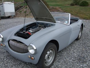

i am wishing to run 5.5 on the front and 6 inch by 15 on the rear. i am concerned about fitting the fenderwell but not outside the body. i emailed minilites.uk and they recommended rear...6 by 15 with 104 mm backspacing and 5.5 by 15 fronts with 102.5 backspacing. my car has splined wheels so it is difficult to measure properly for bolton wheel locations. do you have a side view of your car with the factory steel wheels? i have the proper parts for the hub conversions and a nice set of factory wheels and hubcaps.....but i prefer the minilites. as the picture of my car shows i currently have minilite type wheels with splines...they are 6 by 15s and fit nicely.
Max, this is about the best picture that I can find right now. I think your wheels right now stick out further than mine. I think I'm running 165 X 15 tires. My car is in my paint booth right now on jack stands so I can't give you any current details right now.
