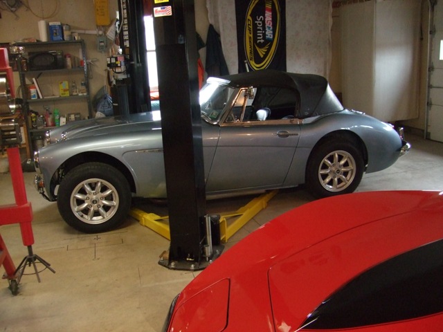

Hi MaxWedge. We had a discussion about this back in August. If you search this forum with the title words "Minilite Wheels" and my username "Vette" you will find at least two post about my search for the wheels you are looking for. I contacted all of the usual suspects about Minilite wheels for my 5 lug BJ7. They all said they do not supply any "Minilite" type of wheel for the 5 lug Healey. Which is 5 on 5 by the way. Only Moss list a number for a "Minilite Like" wheel for the Big Healey. And it is 5.5" wide. So wanting new wheels for my car, I bought them from Moss. And they have stamped right in the casting, " MADE IN THE UK ". And they're pretty nice. And my BJ7 is alot smoother with them and the new tires. So just to let you know, I'm happy with them. I'll try to attach a pic. Dave.
PS: by the way, I have new Nexen 165/80-15 tires on them. You can go up to 185s but i decided to stay with the 165s because that is want has been on my car for years. You note if you read some spec from different tire manufacturers that the will state that 165 tires can go on a rim width from 4.5 to 6.0. Then some manufacturers won't state that. I searched for weeks to verify that the 165s will work on the 5.5 rim width. As an example, Coker Tire states the rim width for 165s is 4.5 to 6.0. Anyway, Good Luck.

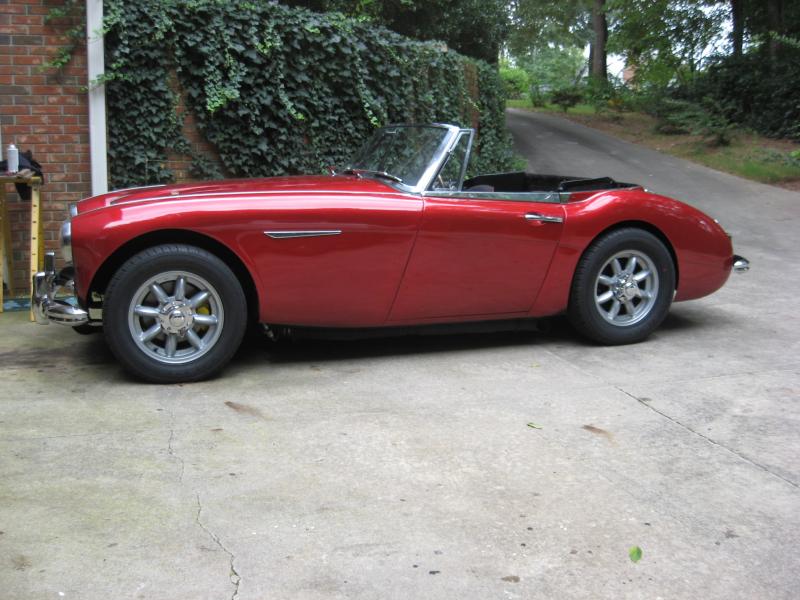

IMG_1427.jpgthanks for the responses. for information...after exchanging several emails with russ at minilite-uk, they can supply a set of minilite wheels...5.5s for the front and 6.0s for the rear complete with nuts, center caps, and logoes for and shipped to south carolina for approximately 1120 us dollars....i do not know how long it will take to get them as i have not asked. most likely will order the minilites! i have minilite style spline drives on the car now but prefer bolt ons. i think that these were ordered from moss! i have corrected the side flashes since i purchased the car!

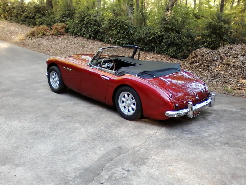

well after months of deliberation i have completed the necessary front and rear hub changes necessary to mount the 5.5/6 by 15 minilite wheels on my 63 bj7. very pleased with the wheels but had to downsize the rear tires to provide adequate clearance to the inner wheel wells. if i could have found longer wheel studs i could have used the 225/60/15 tires that i was running on the k&n spline drive wheels. speaking of, i have a very nice set of k&n spline drive wheels for sale at a very good price. the wheels and three eared knockoffs are in very good condition. anyone interested in the spline drifve wheels and knockoffs please send a pm for pics and details. thank you.

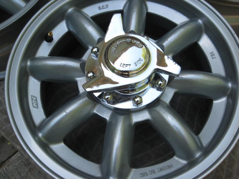

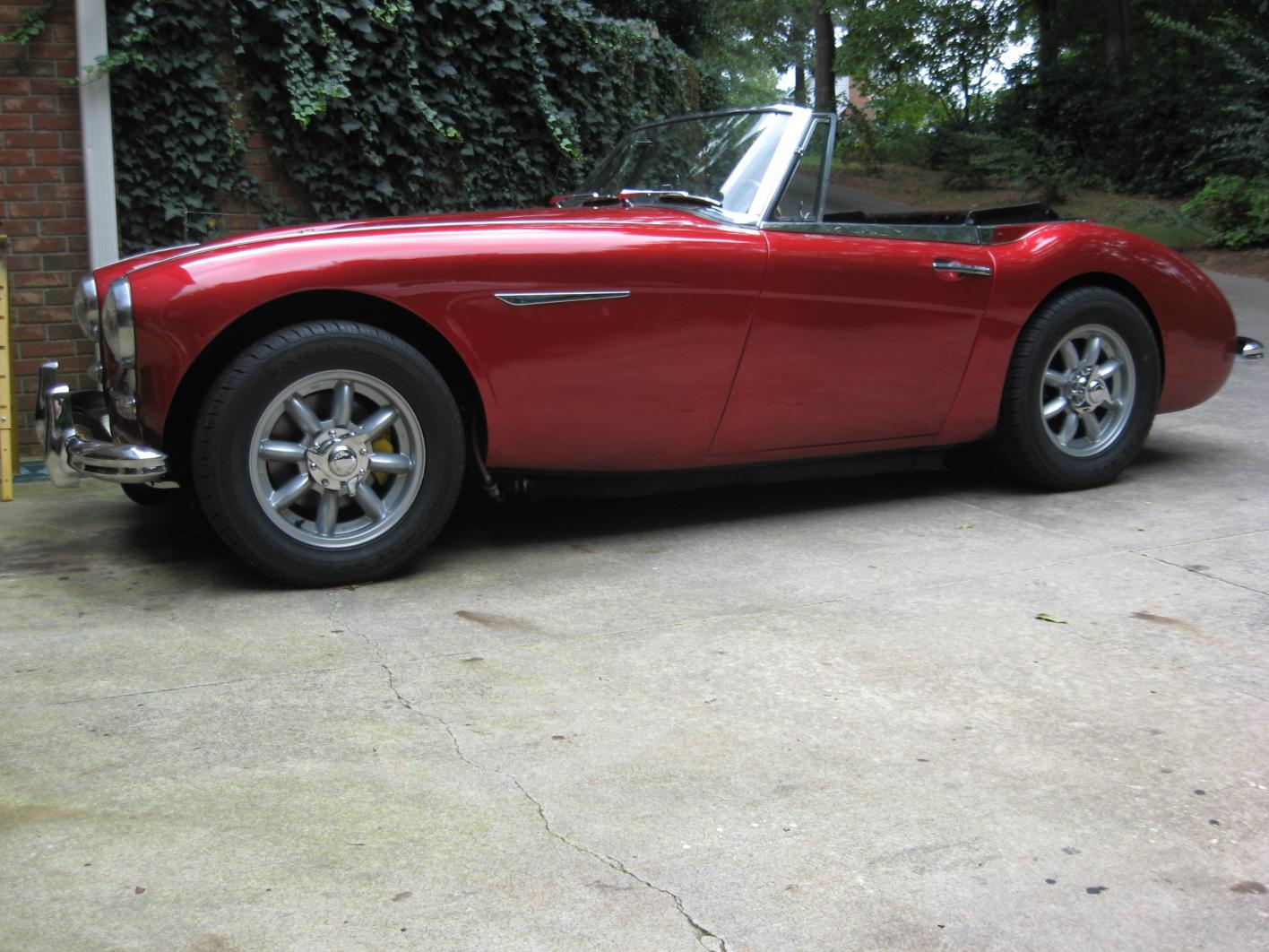

well after months of deliberation i have completed the necessary front and rear hub changes necessary to mount the 5.5/6 by 15 minilite wheels on my 63 bj7. very pleased with the wheels but had to downsize the rear tires to provide adequate clearance to the inner wheel wells. if i could have found longer wheel studs i could have used the 225/60/15 tires that i was running on the k&n spline drive wheels. speaking of, i have a very nice set of k&n spline drive wheels for sale at a very good price. the wheels and three eared knockoffs are in very good condition. anyone interested in the spline drive wheels and knockoffs please send a pm for pics and details. the wheels for sale are pictured below. thank you.

The minilites look fantastic.

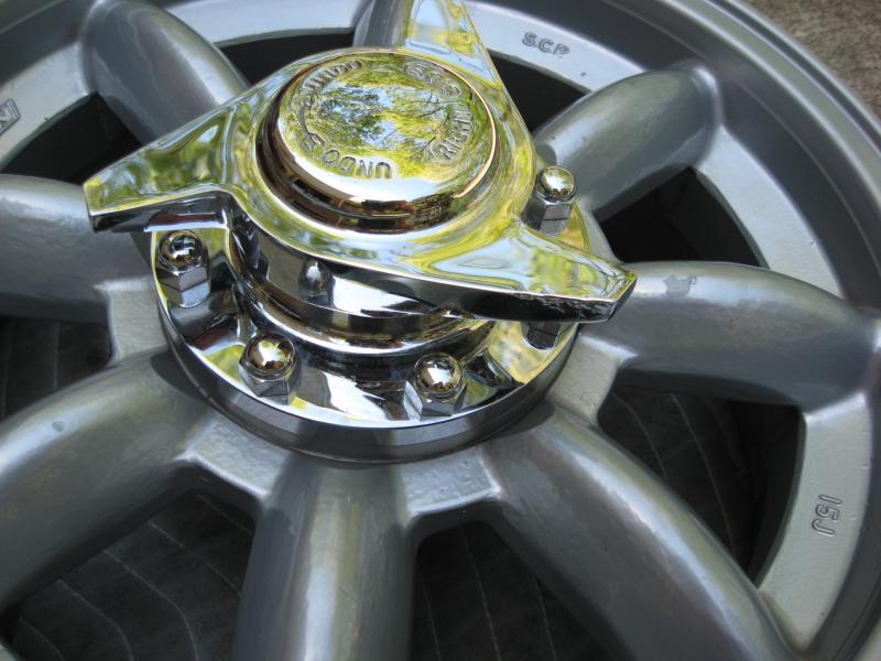

i sold the spline drive wheels but still have a very nice set of three eared knockoffs for sale. these are in very good condition and i will sell for 30 dollars each plys shipping. retail for about 95 dollars each at moss....a bargain if you are looking for a set. they are coarse thread... i just show two but i have a complete set of four!!!
