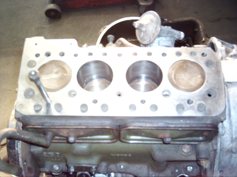

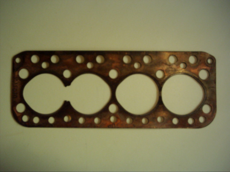

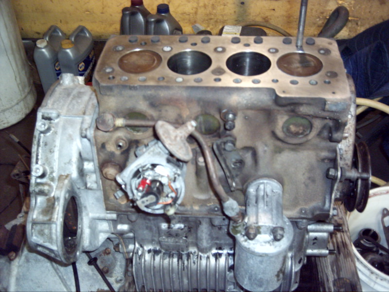

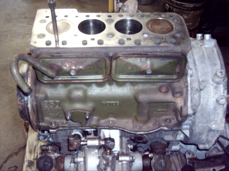

I am going to attempt to post the pics Terry took of my engine.
Tell me what you think based on what you can see.
The blue links are additional pictures.

Re: Mini up-date
That certainly is a well burnt through head gasket.
As Nial said earlier, for the effort involved so far it certainly would make sense to have the head surfaced at the minimum.
I can't tell anything from the pictures. If there is bad pitting or burning on the top of the block then it should be decked. If your brother-in-law is working on the engine at home, suggest that he go to the hardware store and get them to cut him a piece of window glass (not plastic) roughly the same size as the head. You can use that as a flat surface and get a rough idea if the top of the block is warped or not. If there is no burning or pitting and the plate glass shows it's reasonably flat (say.. no more than 0.003" out of flat... checking against both sides of the window glass) then I would use the block the way it is.
When you buy a new head gasket, see if you can locate a Payen "black" gasket for the small bore engines. The Payen gaskets have a sealant on their surfaces and they have a reputation for superior performance on street cars.

Peter, the A-series has a reputation for blowing head gaskets. However, it is certainly more common on the large bore engines than on the 850s. I would check what you have for flatness and burned surfaces before giving up on the engine you have.
As for the extent of the gasket damage, that can be very misleading. Once a tongue of flame starts shooting back and forth through even a pin hole leak in a gasket it can disintegrate very quickly. Your engine was probably running fine one moment and within a couple of minutes started feeling very wrong.
Again, look at what you've got and decide if what you have really isn't fixable. My gut feeling is that you need to have a skim cut taken off the head to restore it to flat and you obviously need a new head gasket. If the block isn't burned and measures flat across the top... a little head work is a cheap way to get back on the road.
