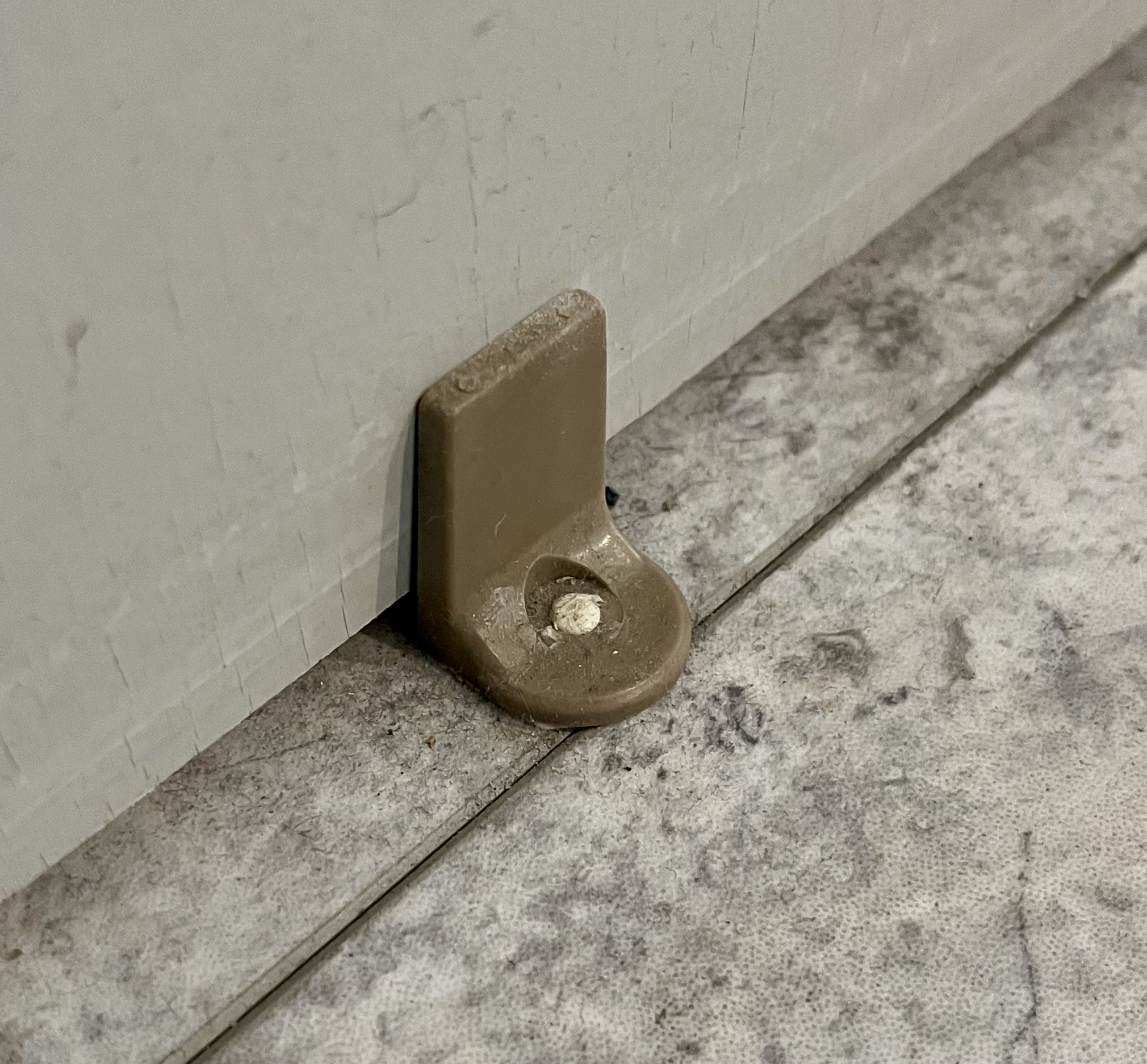

In my on-going Bathroom remodel, now that I've completed tiling the floor with porcelain tiles, I have installed a new set of sliding doors for the walk-in closet. Installing the new track in the header and hanging the doors (which came in about 20 pieces - must have been designed by IKEA) was relatively easy. However, now I have to affix a bottom "Dorr Guide" piece to the floor in which the two doors will pass through as you open' close the doors.
I am terrified at the prospect of drilling holes in the newly laid porcelain tiles as I know porcelain is very hard and also very brittle (prone to cracking).
I've seen these "Diamond: drill bits and was wondering if anyone has experience with these for drilling in porcelain? My thought is to drill s a couple of mounting holes, then tap in some plastic plugs and screw the screws into the plugs to hold down the door guide piece.

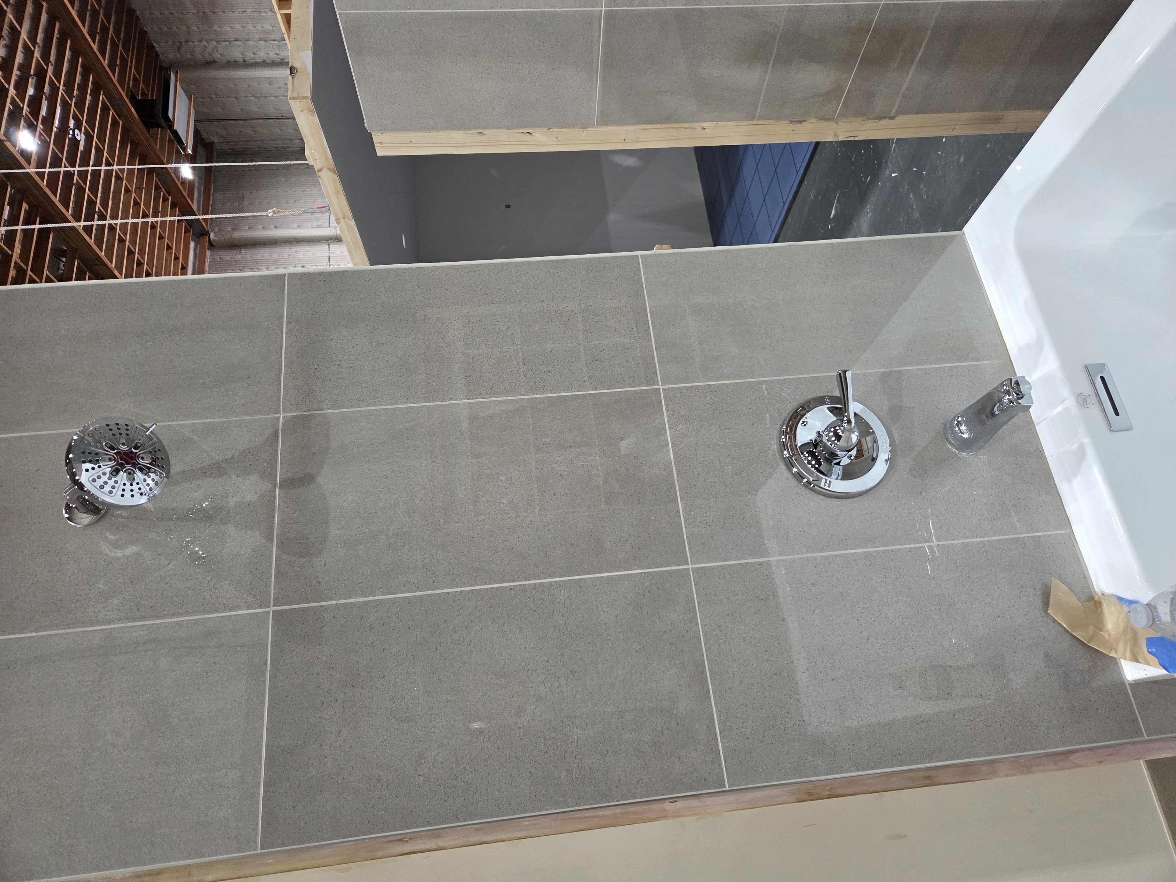

Well shoot, I just realized that in fact I have used one of these Milwaukee Hole saws before, but I had forgotten about it because it was much larger (1 inch) that the application I need now. I now remember that I bought a 1" version of this type of hole saw to cut the hole in a 12x24" porcelain tile to accommodate the shower head pipe in my shower. As I recall, that thing cut through that tile with only minimal effort (of course keeping it wet as Worked.)
So, I went ahead and pulled the trigger on a set of three in different sized (3/16, 1/4 and 5/15). The listing says it's specifically for "all porcelain, tile, and stone." I'll practice on some scrap tile before attempting it on my finished floor (my fear is that I might crack a tile, which would be a disaster). My thought is to drill the holes in the porcelain tile (and underlying concrete) to a sufficient depth to allow me to insert a tight-fit plastic plug into which I can then screw the door slide to the surface. While I'm at it, just for good measure, I'll probably use some construction adhesive like FuzeIt just to add some strength.
