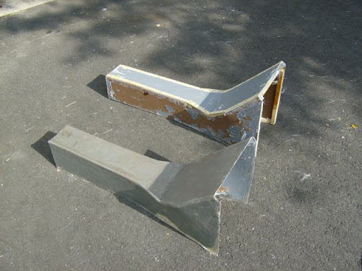

Haven't posted in a while and haven't worked on the midget since early Spring (but gave it a lot of thought). Anyhow I've been trying to figure out how to redo the interior since the shifter moved back about 4" when the 5 speed went in. I decided to make a console since the only one I could find was a fiberglass generic and cost about $270.00 with shipping. Here's the results....
The form made of plywood and pressed board is on the top and the almost finished fiberglass console on the bottom.

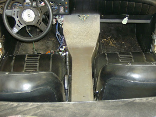

Here's a dry fit.
I plan to carpet the sides and where it attaches to the front (to get rid of the black vinyl) and will probably put walnut burl formica on top.

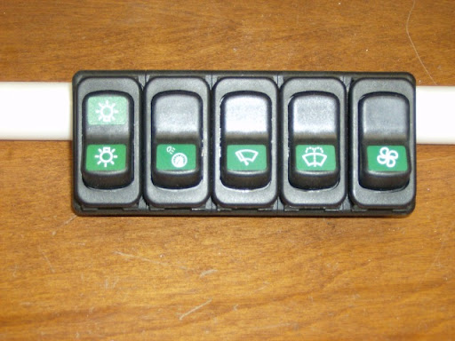

If the formica looks ok I just might do the glove box door and the dash since new gages including volt meter and oil pressure, ignition switch, and indicator lites will be installed. The console will have Dun-Rite switches for lites, interior lights, wipers and washer, fan, and maybe a clock.
Here's the switch arrangement.
The console ended up costing about $85.00 in materials and maybe 2 days labor.
