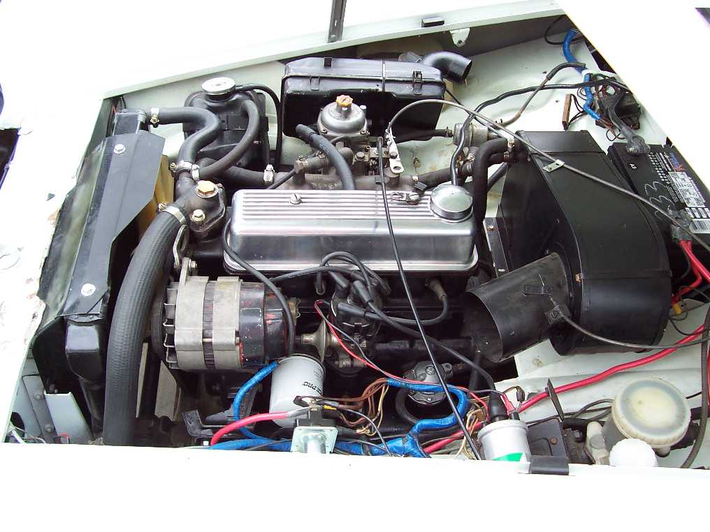

What year MG 1500 do you own? I don't have any pictures but I own a 76 Midget and would be glad to take some pictures for you. My Midget is not a California model so I don't have a smog pump. Provide your email address and I'll send some to you.
Hope this works.

Wow Phireman, that pic had me totally confused for a minute. /ubbthreads/images/graemlins/confused.gif
The pic must've gotten reversed!! Those 1500's always get me.
Nice looking motor by the way....

Thanks. It's not a bad pic. I needed more of the places where it actually attaches to the engine, but I'll take it and look at mine tomorrow. cause I'm not sure if mine is attached to that engine lift thing at the top. But I've taken it off and on so much, I really don't remeber what I've tried. It's at a friends house and it's now night time here, so I'll let you know tomorrow
Nope, not reversed. That's pretty much the way I remember it. But you're right that Phireman's is looking really nice.

Thanks for the compliment, guys.

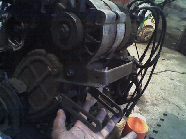

No, here are some bad cellphone pics. Can anyone tell anything from these?

I've got a 1500 midget as well and looking at your pic I'm not sure what I'm looking at. The Alt should be attached to the block at the bottom - this is you pivot point. The top of the Alt should be bolted to an adjustable bracket that doubles as an engine lift point. This bracket uses one of the water pump bolts on the head. I'll try to find a good pic for you.
This is where the Alt attaches to the engine. It looks like you have a bunch of un-needed stuff under the Alt. (those two brackets your hand is on in the pic) What does the top of the Alt look like? Is it attached to the correct bracket?

The brackets in the cell phone picturre are mounted correctly. The lower attachment points are for the smog pump. Lee's photo is for an alternator mounted without a smog pump. Phil It took me awhile to figure the brackets out as our car came in bushel baskets.
