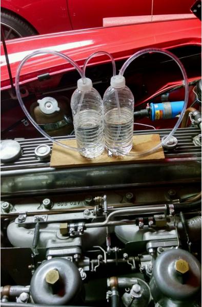

My sole tip is to be sure that there isn't enough suction to suck up a big plug of water__you have a considerably larger reservoir than the average tube-type manometer! A hole in the sensing tube, something that can be partially blocked with your finger, would be one type of failsafe (I know you can take that little tidbit of info and run with it; no shortage of imagineering on your part ).
I once did just that, it was even tinted with some Dwyer green dye; fortunately, the U-tube that I used doesn't have much capacity, but one good blip of the throttles, and it was gone!

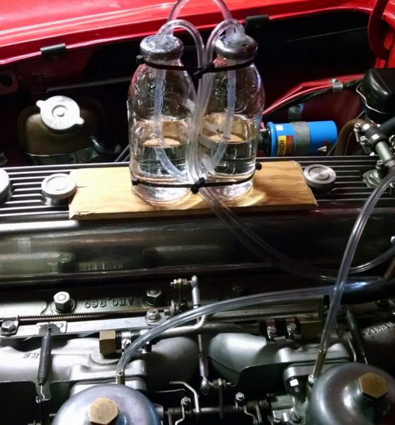

OK - did the sync with the snapple bottles. Worked well, though have to say the crudeness of the linkage is the main problem with getting a good sync. No balance screw like the Webers or 240Z SUs. The 16oz snapple bottles are a little small. 750 or quart glass bottles would be better as they give you more water to work with.
In my case, the rear carb seemed to have more draw, so I adjusted the fast-idle screw back and forth on the front carb to achieve balance.
IMO it's better than the other methods because you don't have to remove the air cleaners.

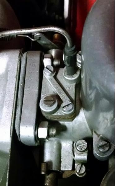

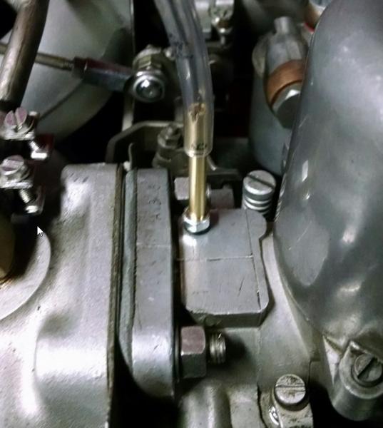

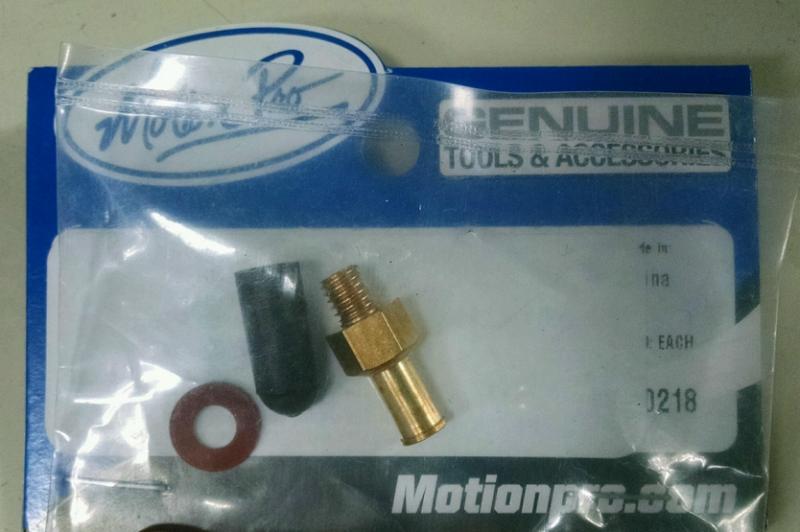

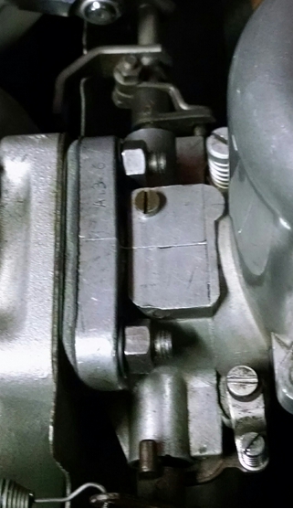

Final version: replaced the long tubes with these permanent M5 x .8 stubs. For a more permanent plug, replaced the rubber caps with 4-40 SS allen screws.
