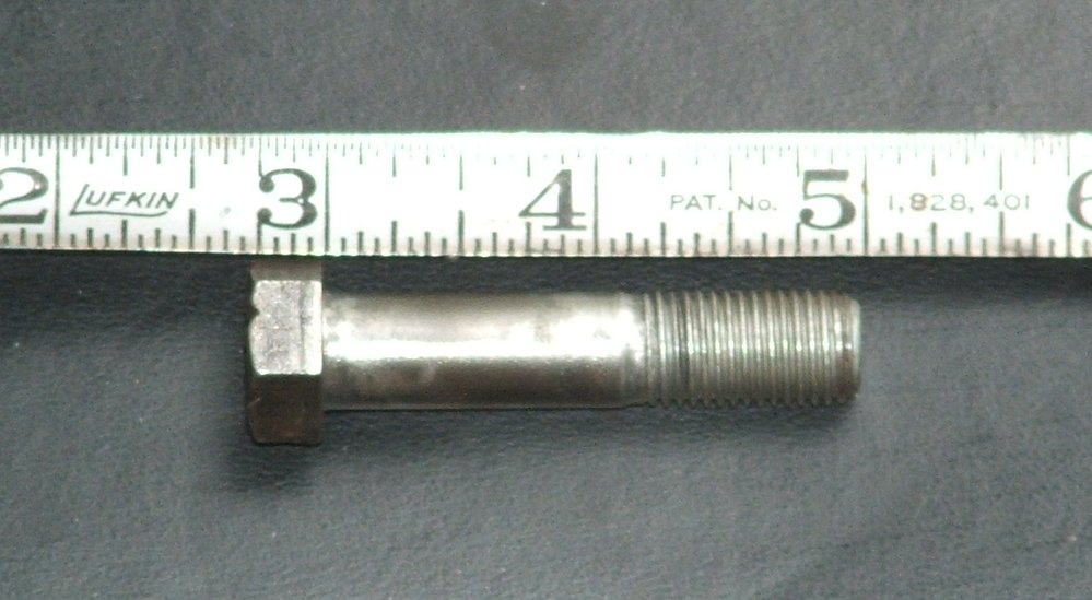

Can anyone tell me the length and diameter of the bolts that hold the steering arms to the front stub axles an an MGB.
Parts sites only list the bolts, they don't tell you the size.
7/16" dia. 5/8" head. N.C. Likely grade-8 (or ~should~ be):
