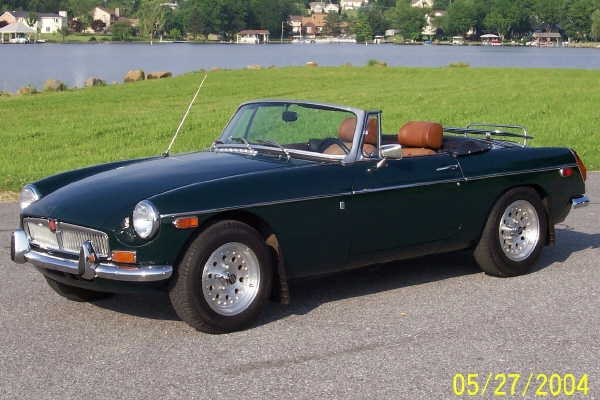

Here's mine. 14x6. American Racing Outlaw II's.
(see attachment)
